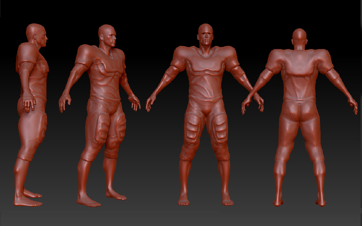

I spent about 2 hours here tonight and this is where I am at. I found a Male starter sculpt and built the paddings and clothing from there. It definitely looks like a football player! I am having problems with the belt area but perhaps once I actually get the belt in then it wont look so weird? What you all think? :slight_smile:
