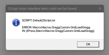

I hope someone can help me.
‘I have upgraded from Zbrush 2024 to 2026.
The startup script created above has loaded my grid on startup fine from Zbrush 2022-2024.
‘however, I get errors using it in 2026.
I have tried a variety of fixes and can not get it to work.
Could someone please give me a hand I would much appreciate it.
Screenshot_1
