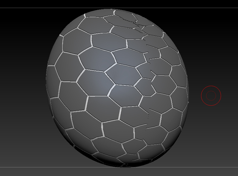

HELP! Surface Noise not matching up at the Seams HELP!
I’m finding it impossible to use Surface Noise across a circular object without running into these seam problems. I Uved the shape and I attempted to remesh it with different patterns. I honestly have no idea how to fix this. Help is greatly appreciated.
check your uvs. they will have to aline if you want total coverage, or use the surface noise as a mask , fill it with a colour then paint out the irregularities… or create clean polygroups and use uv master with polygroups on…
