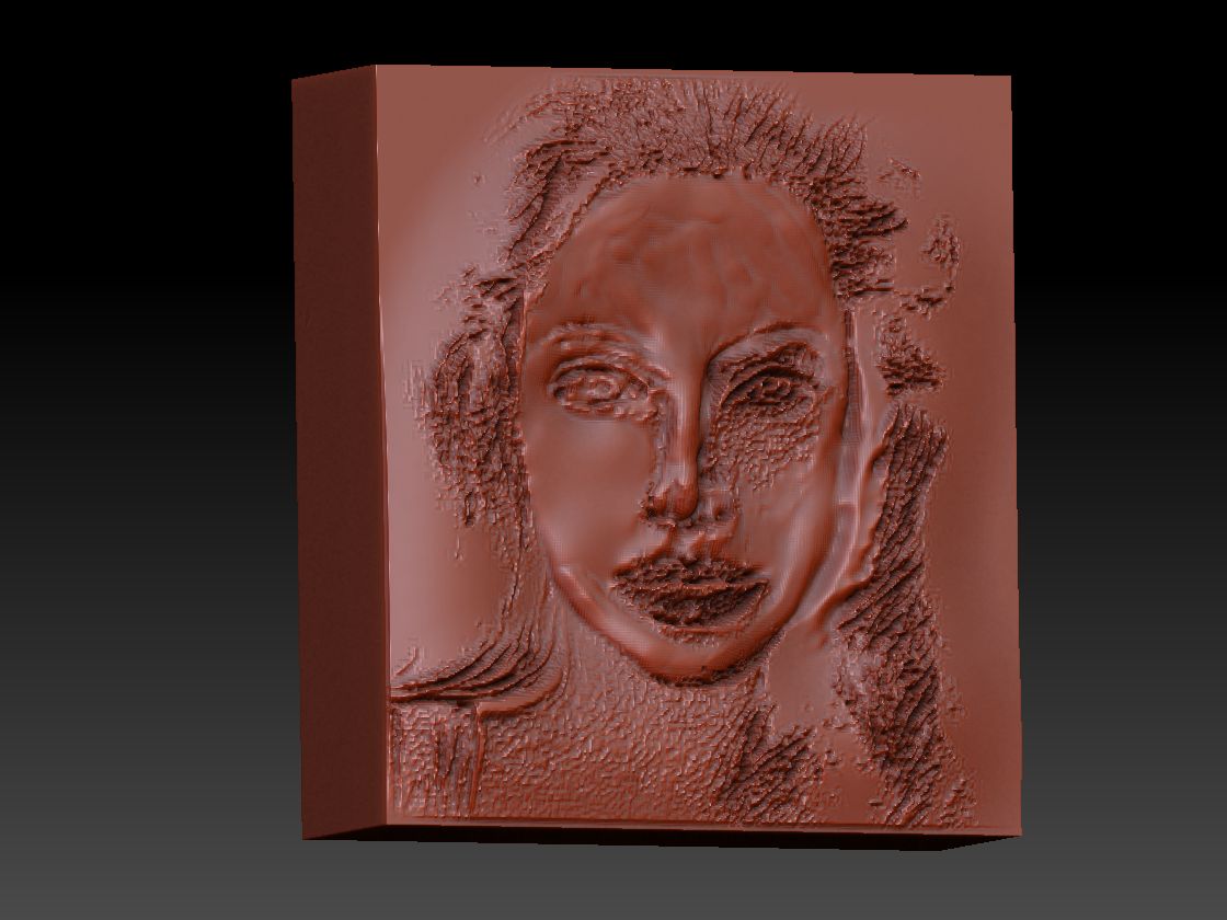

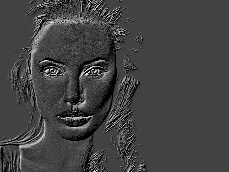

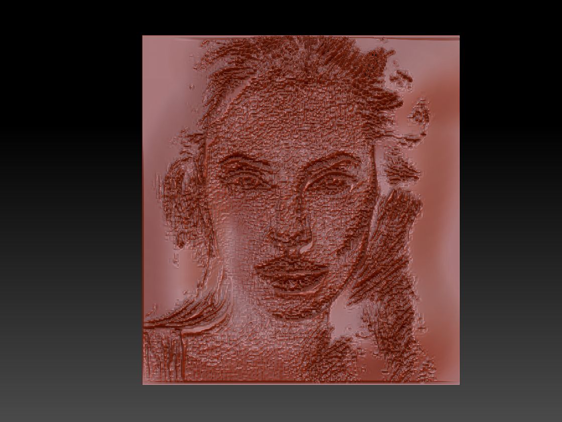

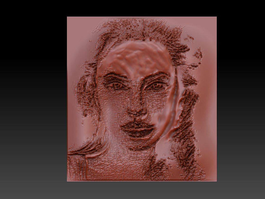

I did reliefs of people long time ago but now i am very very stucked and dont know what to do, how to engrave the model if feels like its going very wrong…
I posted some images that the way i am trying to do it now but i think i am so sucking it up …
If anyone did works like this (reliefing) Pls give some tip and help…:frowning:

I suggest first finding a good resolution picture. Make it black and white and bump up the contrast in photoshop (or a similar program). In Zbrush project it on to whatever surface shape you need as a mask (drag rect, or importing it to an alpha slot and then choosing the tool-masking-from alpha feature). Once you have the object with a mask of Angie, invert that mask, go to deformation tab - and infat a bit (1-2) then smooth (as needed), repeat the drill for as many times needed. Do not enter a large number in inflat and a lartg to smooth to speed up the drill, cause it won’t give same results.
