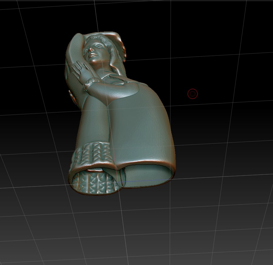

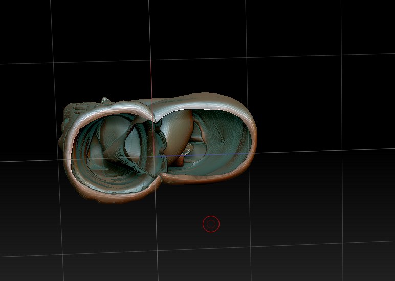

I am havein a problem about getting rid of the inside part of the model. I made the model with more then 1 subtools and after finishing i merged all togather and made it one polygroup. I need to cut the under the model casue i will 3d-print it so i need the under it empty for less weigt . But after cutten i faced those inside part that remained from previous subtools. How can i get rid of them and only get the outside part?
Thanks
Hi, most likely there are a dozen or so ways of solving your case, but here is my 2cents
with 4r2, try to add a sphere that you shape into a “cap” to fill the bottom. If you merged all the subtools together, make of copy of the merge, use dynamesh to “melt” the shapes into one solid object and then use the project button to get back the detail. Of course the last step precedes adding subdivision levels to your newly made dynamesh subtool, else you won’t get the detail.

Thanks a lot i will try to do that tho couldnt understand very clear but a least i will see it on the way
