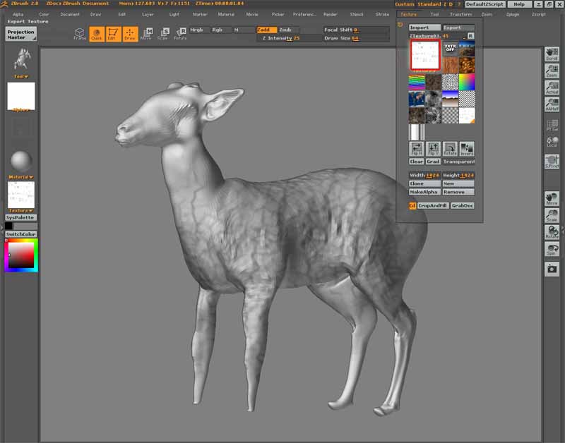

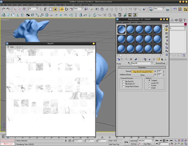

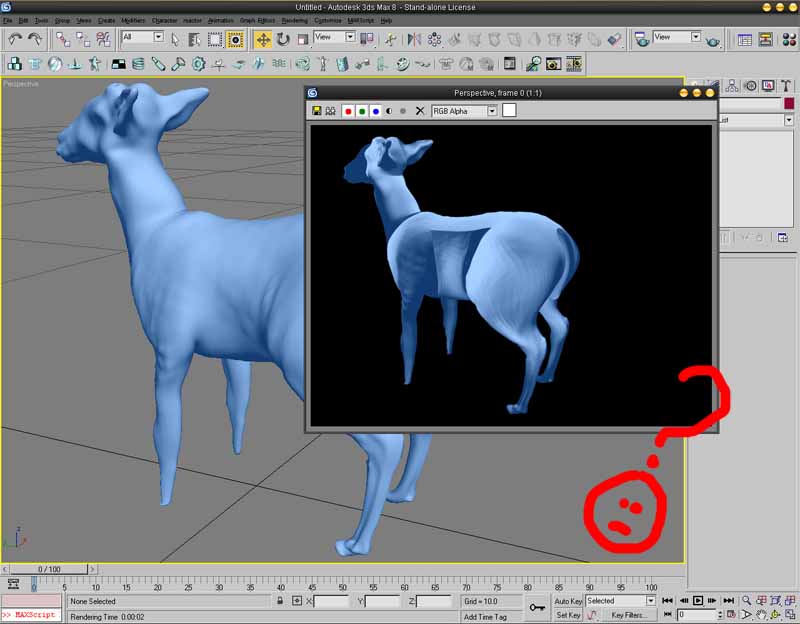

how can I create a Bump map in zbrush to use it in 3d max ?
look this is my steps :- (( to see my error:D ))
1- In zbrush :
how can I do that in Zbrush ?

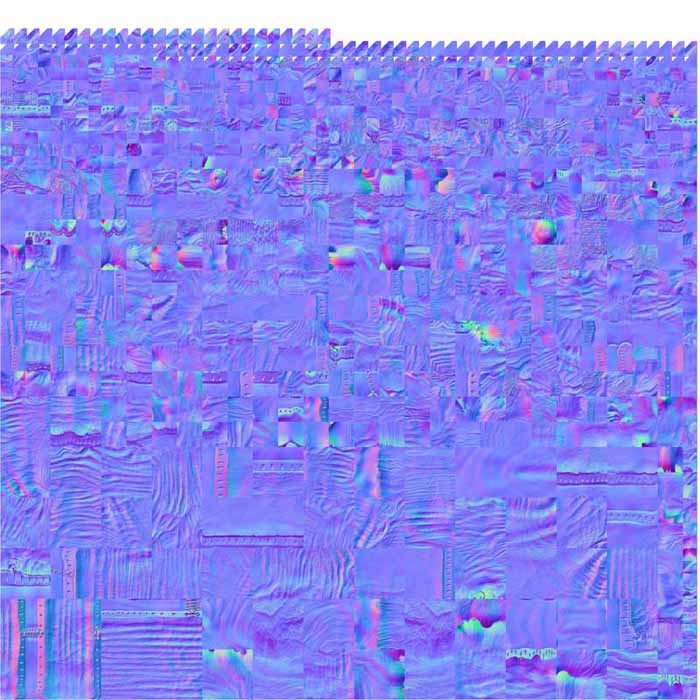

You’re confusing bump maps with normal maps. Bump maps are grayscale. Normal maps are colored. Your shader setup appears to be for a normal map, but you’re applying a bump map.
After you have done your high resolution sculpting, load ZMapper. That will let you create the normal map. You’ll find the download link for it here at ZBC, and it comes with its own manual.
