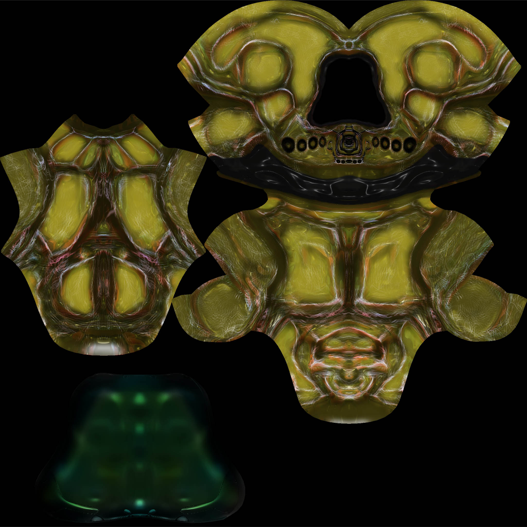

As you can see, I have used a reflective Matcap on the visor of my character and i am wondering how i transfer this detail to a texture map without it loosing its reflective look?? Is this possible?
Below is the diffuse texture and as you can see it only holds the RGB detail of the Reflective Matcap that was on the visor (the greeny blue patch).
So how do i go about transferring the material from the zbrush model visor onto a texture that can then be loaded onto a 3k poly version in 3ds max?

you can not transfer material details, only color information.
If you want to achieve this same look in realtime inside of max you’re going to have to use a dx reflection map and apply a reflection cube map to that shader to achieve a similar effect that you have inside of zbrush.

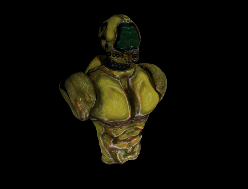

This is how far i have managed to get just baking in the matCap detail (plus its changed slightly)
This is a Current 3dsmax render of the model from 3mil poly to 3k poly looking not soo bad atm wot do u guys think??

if you’re using displacement maps that isn’t realtime…unless you happen to be using DX11 shaders. That is being divided during rendertime to make that super smooth.
You need to set up a composite material with material masks to work with different shaders on different places in your model to make that work correctly. I don’t use mentalRay so I can’t help you there. I’m sure you can find some tutorials online that cover using masks with shaders inside of max.
