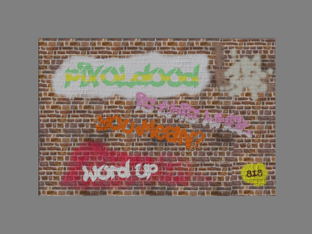

I think you can do anything with this app! May not be what you are looking for but this took literally 5 min.
Simple pl3d…add a tilable texture in PM…send it to your favorite paint app from PM and there you are.

the eseast way:
ProjetionMaster and ZAPPlinkPlugin. Then place the graffiti in Photoshop.
Greez
Hilmar

I used PM and Applink to make the wall and leave it as a tool. Pixoldood mentioned turning it or positioning it on an angle.
If it were just being dropped to canvas, I would have done it only with alphas and stencils.
