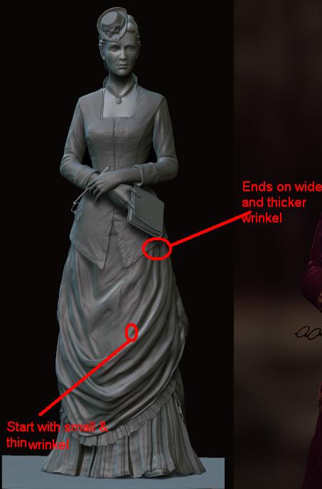

not quite sure what you mean by small bump at the beginning and thicker one at the end :o - could you explain?
sorry for answering late my internet got sick :)…well from bumps i mean wirkles as u can see in the image, i think u made that wrinkel in a single stroke? and i was asking how did u do that when ever i try to do that thing …overlapping happen. so my cloth wrinkles look wierd and foolish

well I never really do wrinkles in just a single stroke but rather go over them multiple times, smoothing every time and building it through different subdivision levels [starting with level 2 and up] It only takes patience and time :slight_smile:
Thanx a lot Intervain, from now on i will start working on the cloth wrinkel and i will do with patience and i will folllow the tips that u mention above, and may be this time i will end up making good wrinkels , again thanx :slight_smile:
