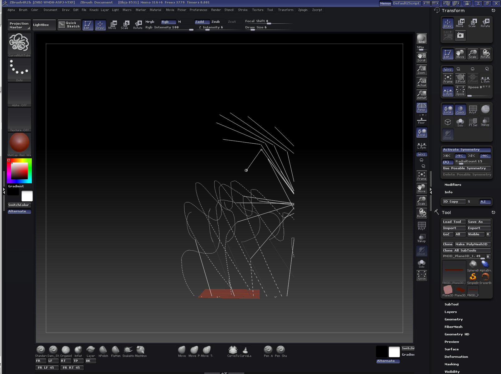

Correction: If I’m zoomed in close before I draw the curve, it will crash. If I’m zoomed out like in the pic above, it is OK.

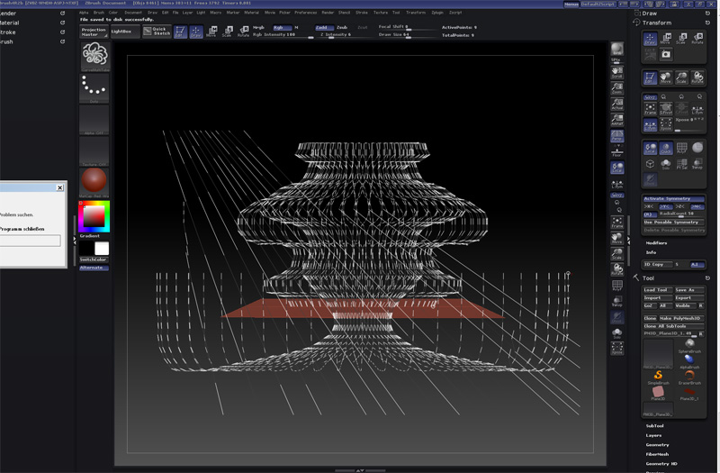

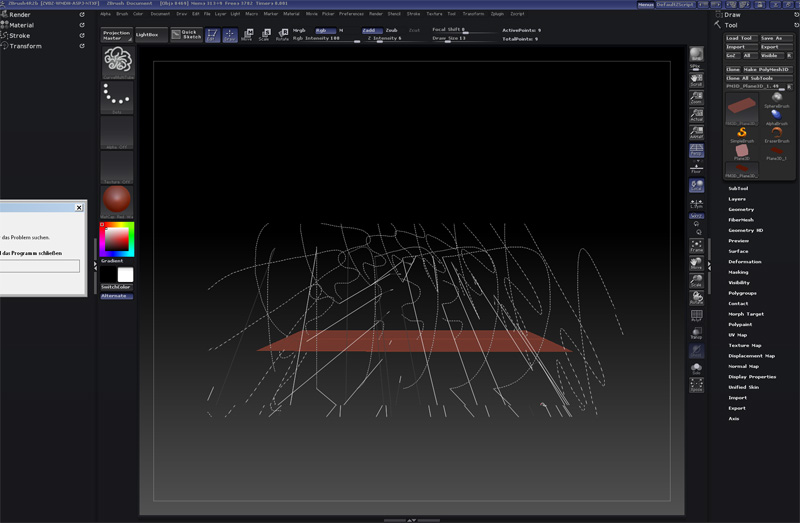

Here some screenshots:

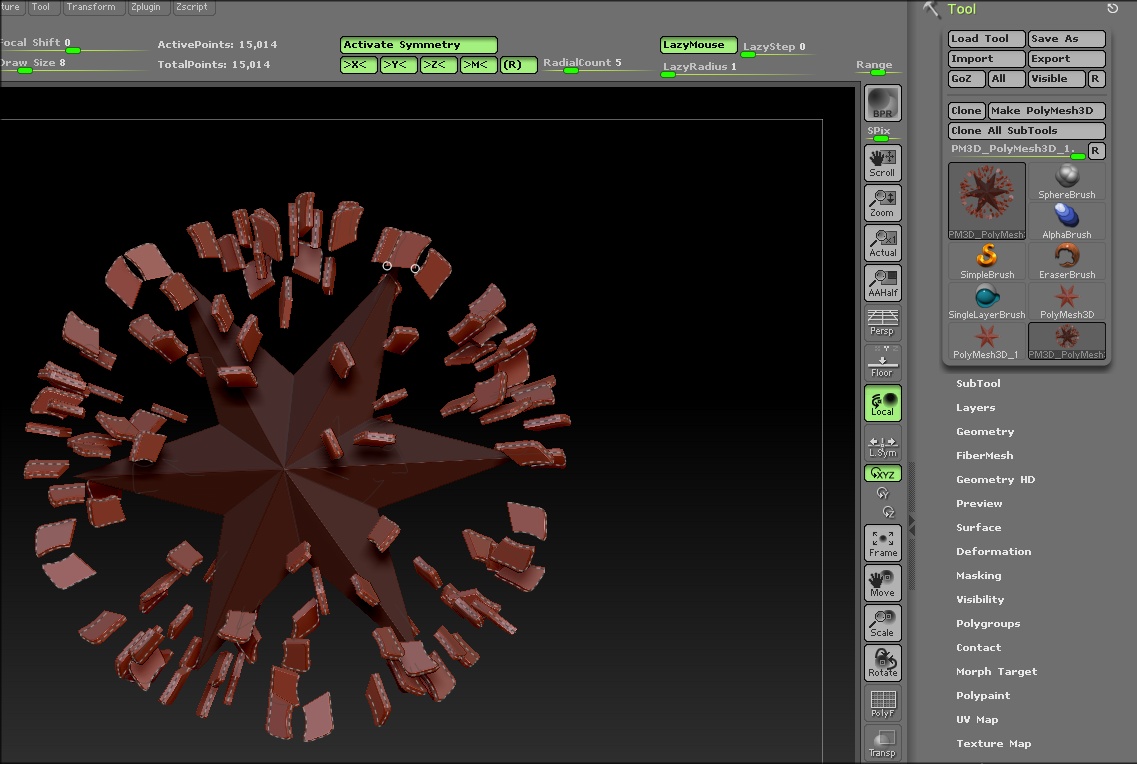

This seems to be a workaround!
Radialcount 16 and curve step around 1 is working without crash so far.
