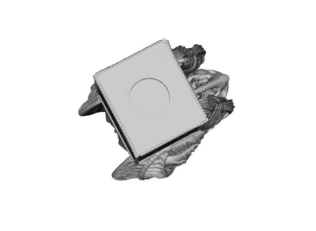

I uploaded my file, which is 4.505 w x 8.481 d x 3.582 in inches, as one solid piece just to see what the price would be like and naturally it was very expensive. I followed a video tutorial on hollowing out the mesh using the insert cylinder tool and dynamesh’s create shell function. I left the hole created by the cylinder to hopefully act as a vent hole and submitted the stl to shapeways to find that the price was only 50 cents lower? I checked out the difference in volume and it’s only about a cm cubed which seems all wrong.
I’m assuming I’ve done something wrong since I can’t imagine that a solid vs hollow print would only amount to such a small difference in price and volume, Is there anyone out there who has any idea what I could be doing wrong? If it helps in the shapeways preview my vent hole appears to be “filled” in the preview but not in zbrush or any stl viewer I’ve opened it with.
Any advice would be greatly appreciated, I’m trying everything I can think of and getting rather frustrated.
Here is the preview image from shapeways that shows the cylinder vent hole now “closed”
