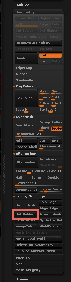

It’s in the Tool > Geometry > Modify Topology UI Group – right below the Micromesh switch.
I’ve read the other posts and others seem to have the same problem. I am looking in the Geometry palette and I don’t see it anywhere. As someone suggested in an earlier post, I looked under the Modify Topology tab and there is Micro Mesh Position and Size, but no DelHidden.

About 3/4 of the way down the Geometry panel, below Micro Mesh.
See screenshot. If you don’t see it can you attach a screenshot of what you can see
Thanks guys for your answers. You must have thought me a complete idiot… I did find out what the problem was. I was using a zsphere that hadn’t been converted to a PolyMesh3D. Until you do, that option box doesn’t appear in the Geometry palette. :wink:
