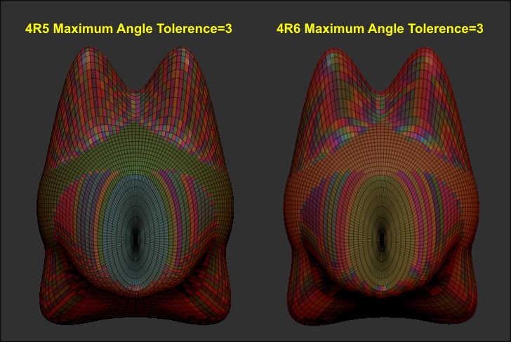

I didn’t see a lot of difference between 4R5 and 4R6. In 4R6, you do get the warning that you are going to exceed 1000 polygroups, but if you click that, it still performs the operation. In the example below, I did a quick sculpt in 4R5 and saved the ZTool so I used the same tool in both versions. As you can see, just about the only difference is the colors of the polygroups.

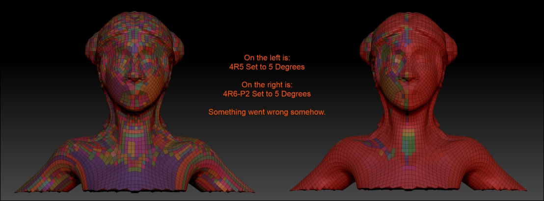

Anyhow here is what I see with the same sort of test you did ZBer, its totally different and not working:
Any thoughts on that?
All settings are exactly the same.
|I should mention that the one from 4R6 is actually one of the best results I have gotten from it so far, there was another that was total chaos and I loved it (even though it was dead wrong) but while I was playing with it I crashed ZBrush by making too many polygons and trying to duplicate them…

I just tried the same test again using the Demohead.ztl and there was a difference with how polygroups were assigned in 4R6. In 4R5, I had the tolerance set to 5, but in 4R6, I had to set the tolerance to 7 to get similar results.
If your ZBrush is acting really wacky, maybe a re-install might be necessary. You already downloaded the full installer so if all else is failing, give that a shot, or start a support ticket and see if they have any answers.
