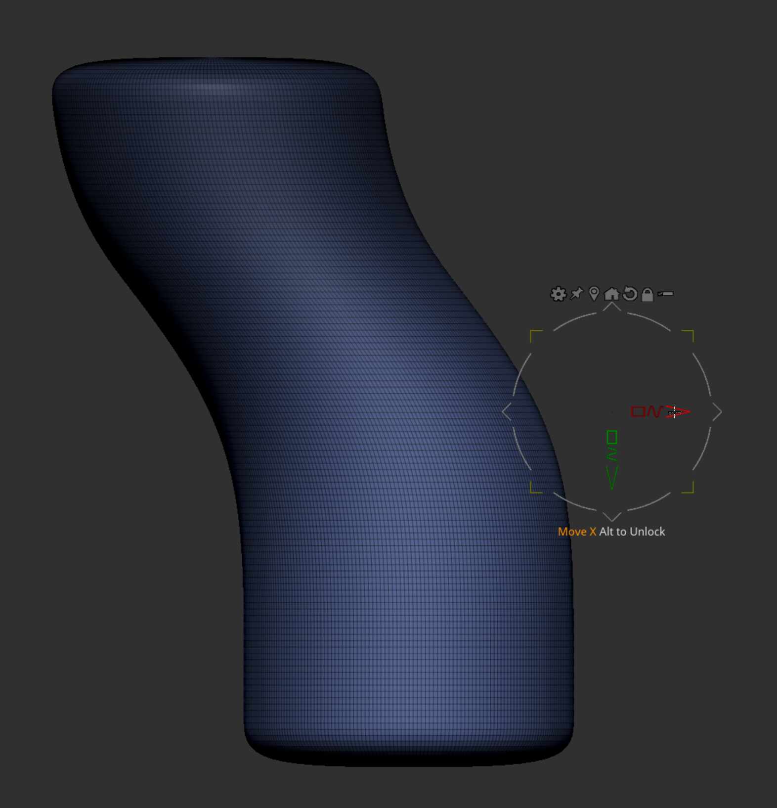

I’ve noticed that no matter how much I blur a mask, a harsh transition keeps appearing when I use the Transpose Move tool:
I’ve tried changing the Brush curve, but to no effect.
Do I maybe have some mode turned on without knowing? AccuCurve isn’t active.

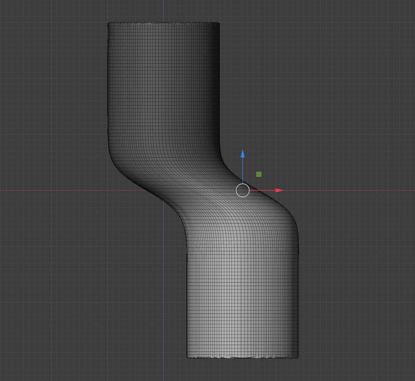

This is what happens in Blender, which seems more logical to me:

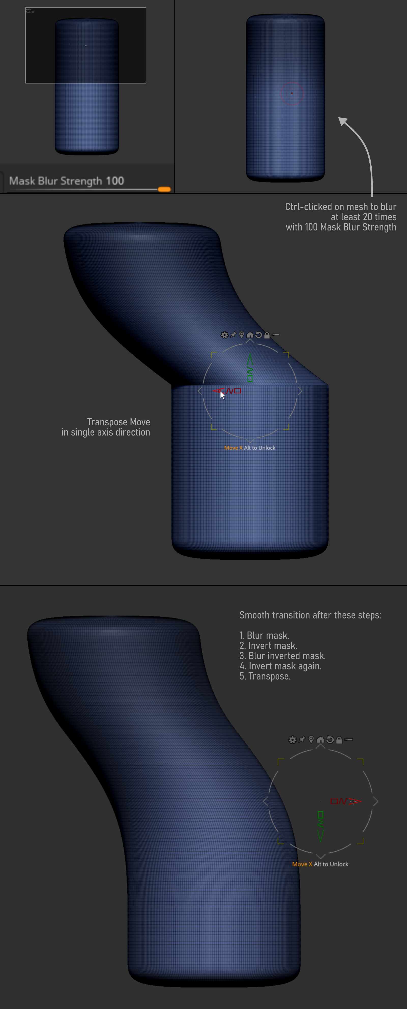

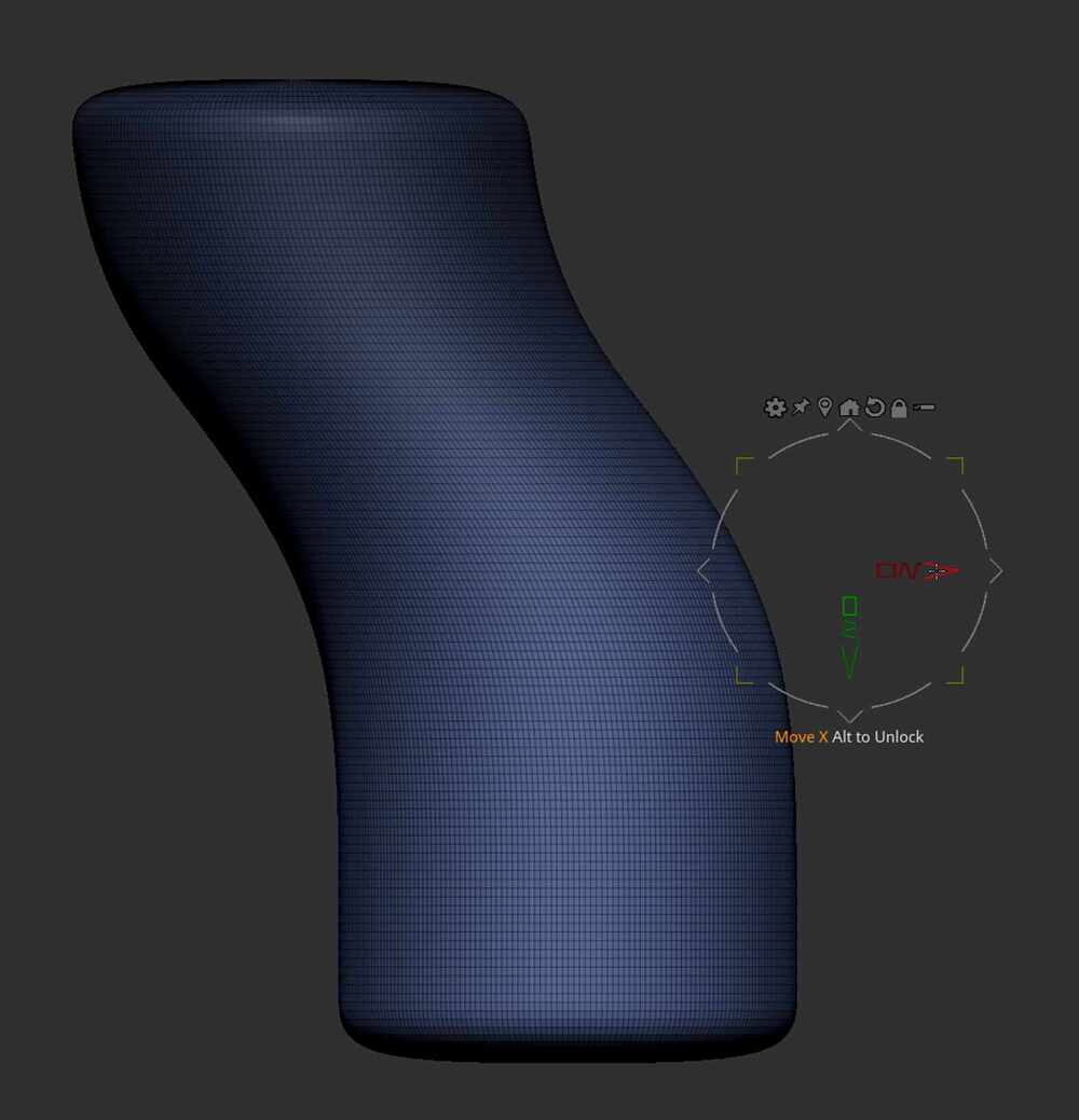

Ah, the solution turns out to be inverting the mask, blurring the inverted mask as well, then inverting the mask again and start moving.
Apparently the blur only affects the masked part, not the average of masked and unmasked area, causing a sharp curve in the mask that becomes apparent when transposing.
So, to wrap it up:

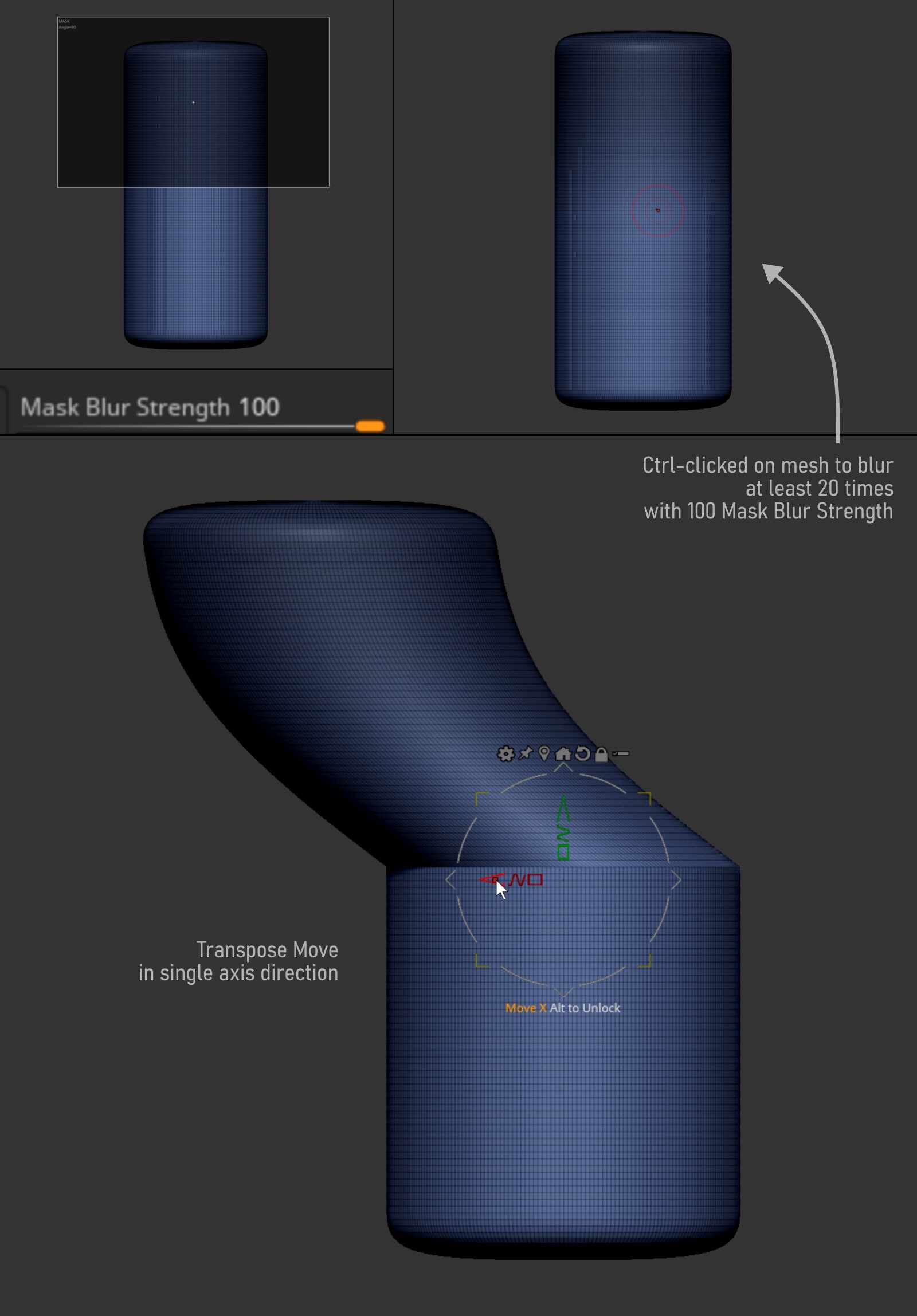

This probably has to do with how you are blurring your mask.
If you are blurring the mask by Ctrl-clicking on the mesh, you’ll notice it only blurs up to the original masking border, but does not blur the masking onto any points that were not already masked. This will result in that kind of transition.
However, if you blur the mask with the “Blur Mask” function in Tool> Masking, it will blur in both directions, including onto points that were not previously masked. This will result in a softer transition.
