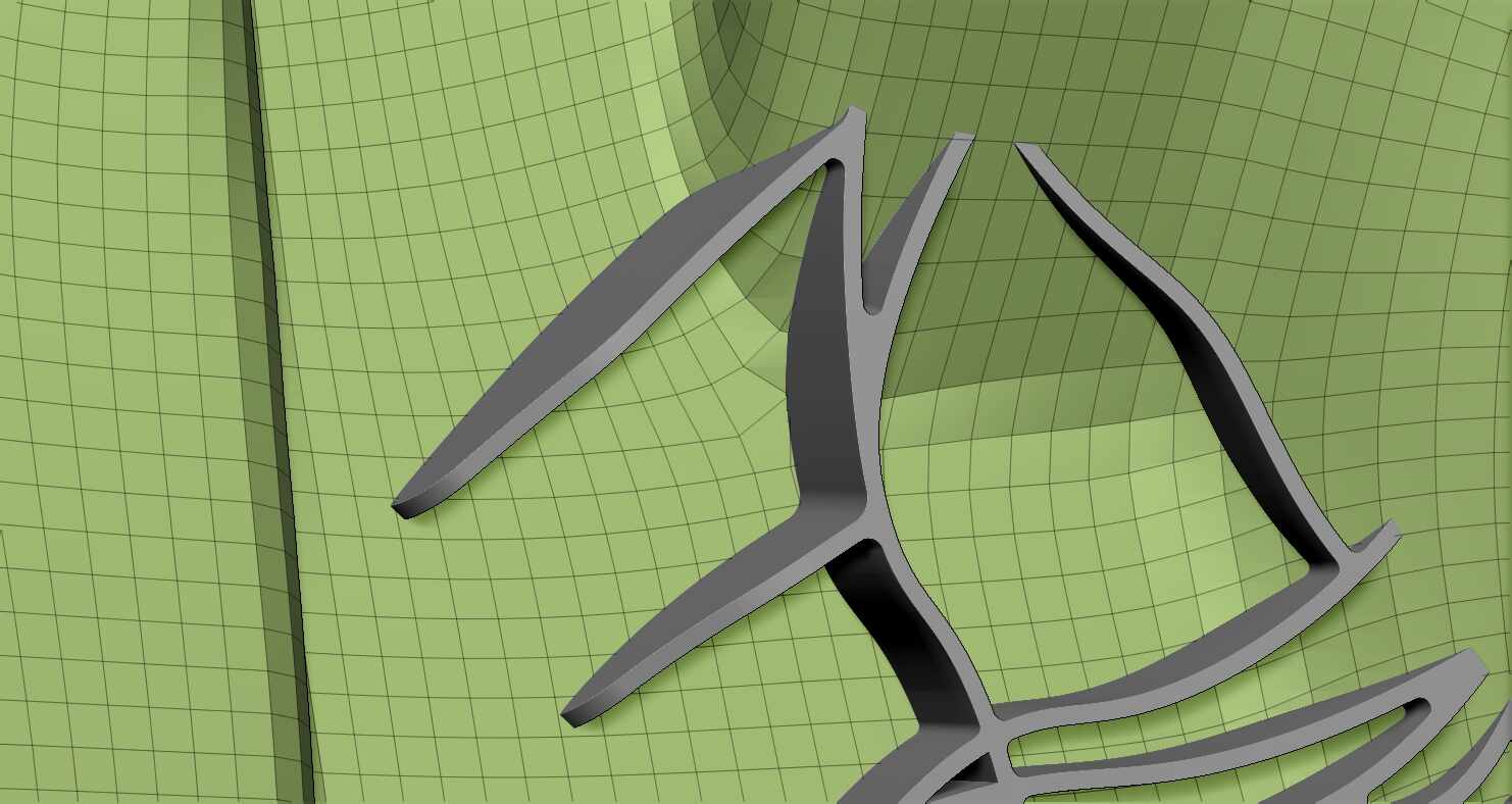

I’m currently working on a project, where I have a pretty big “Base Plate” without much detail (view Screenshot 1, green, ZRemeshed, coarse mesh). Onto this surface, I want to add hard surface ribs, which have a thin wallthickness. These ribs allready exist in a CAD-Software, so they can be imported as an obj or stl into zbrush. You can see a cropped out section in the attached screenshots, only ~5% of the ribs present in the whole model are shown here. What I’m trying to get is a single mesh, where these ribs are properly merged into the base plate, while retaining the hard surfaces of the ribs and the keeping poly count as low as possible. It’s not mandatory to work on the existing CAD-file of the ribs, a complete redesign is also possible, if a suitable approach can be brought up. I would appreciate your help!

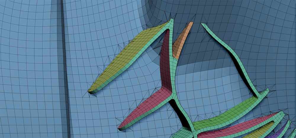

I tried something simillar to your approach:
  • Mesh the ribs with zremesher seperately
  • Merge ribs with the base plate
  • Remesh by union (I think that does the same as your suggested live boolean option)

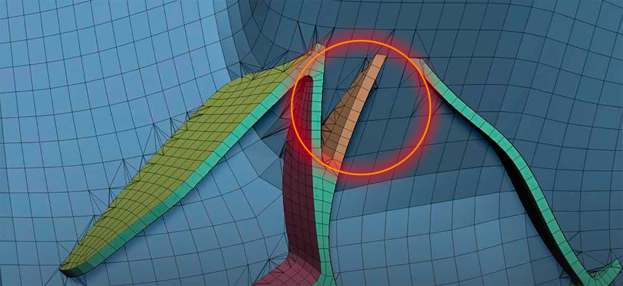

The Interface has pretty tiny trias, as you also mentioned before (view Screenshot). My goal is to have a single quad mesh with a low poly count, which keeps hard edges, so remeshing is necessary. If I remesh this single merged part with zremesher again, it will result in a pretty bad mesh. I tried many options: keep polygroups, keep creases, with defined zremesher guidelines and polypaint density. But it seems like that those tiny extrusions combined with a large base plate are not that easy to mesh. Another idea is to just remesh the interface area, but my approaches for this option also didn’t generate satisfying results up to now. You mentioned remeshing the interface area in your answer, what would your workflow be for that? I would also appreciate every other idea to achieve what I described before.

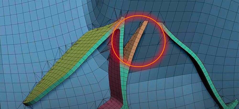

In the image you posted, most of the polygrouping appears sound but you have areas like the following where it is not consistent. In the highlighted area of the image the topmost green polygroup transitions to an orange polygroup, and it’s not clear that the sides are a different polygroup from the top in that area. This will cause the form to break down in that area during a ZRemesh process:
If it looks like the form is breaking down in an area, many times if you Ctrl -Z back to the original topology you can find out that this is caused by tiny polygons near the borders that are a different polygroup than expected. Often this kind of geometry cant be seen unless you smooth the mesh with the smooth brush to relax it, or use Dynamic Subdivision to preview the subdivided form non-destructively.
Likewise you have soft rounded corners in most locations. If you want hard edged interior corners then the surfaces on either side of the corner transition need to be different polygroups.
