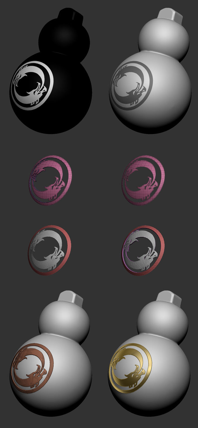

First thing is the environment, which is what is lighting the scene. You can have subtools in zbrush that are used as lights in keyshot by applying a light material on them once bridged but my image is all lit with an environment probe. I downloaded the one I used for free using keyshot cloud. The lighting is super important, I don’t need to say that but a program like keyshot really illustrates how lighting can elevate the subject or make it quickly look wack. I always play with the “rotation” of the environment to see what the look is at any position so I can find one that looks best. I like this environment a lot, especially for that studio look I was going for. Pictured here and named 33

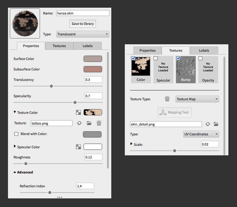

The material used for the skin in keyshot is called “translucent”
Some tips I can give are that I’ve dropped the translucency number any time I’ve used it and tiling a micro-bump map helps. I don’t know if the shader just defaults with a high translucency number or its based on size and sculpts that originate in Zbrush are super tiny so you need to drop it. Be careful not to make your model look too translucent. My character is a bit high because of the stylized Overwatch/Pixar look I was going for. Tiling a micro-bump map for the skin helps break up the highlights further, I’ve sculpted some pores but having an overall noise helps the skin look.
Here are my settings:

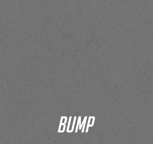

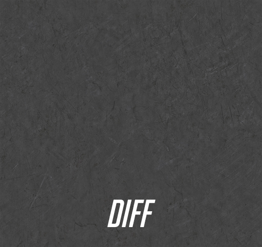

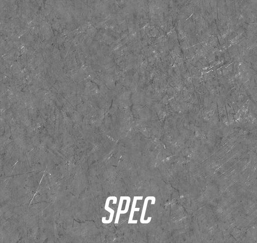

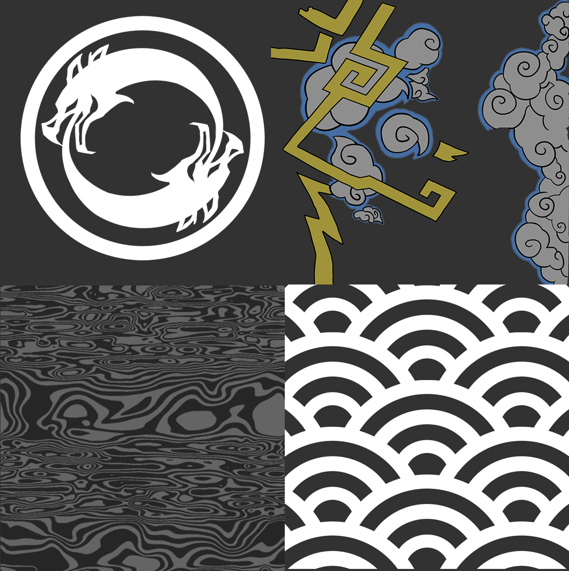

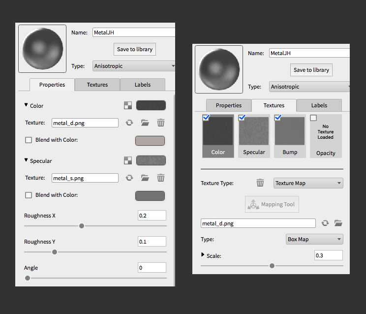

Another tip for keyshot materials is with metal. I found the metal materials were too clean and shiny, especially within a clean studio lighting environment without much color and noise to break it up. After doing some research in what others did I decided to make my own. I started with a “anisotropic” material. This allows me to tweak roughness X - Y and specularity independently. Metal material has one value. Since I felt the metal was too clean this shader is about noise and breaking up that reflections and highlights. I made some maps including a bump so the light had all kinds of imperfections to trip up on.
Here’s the metal material settings:
Here are the maps I made to plug into the material

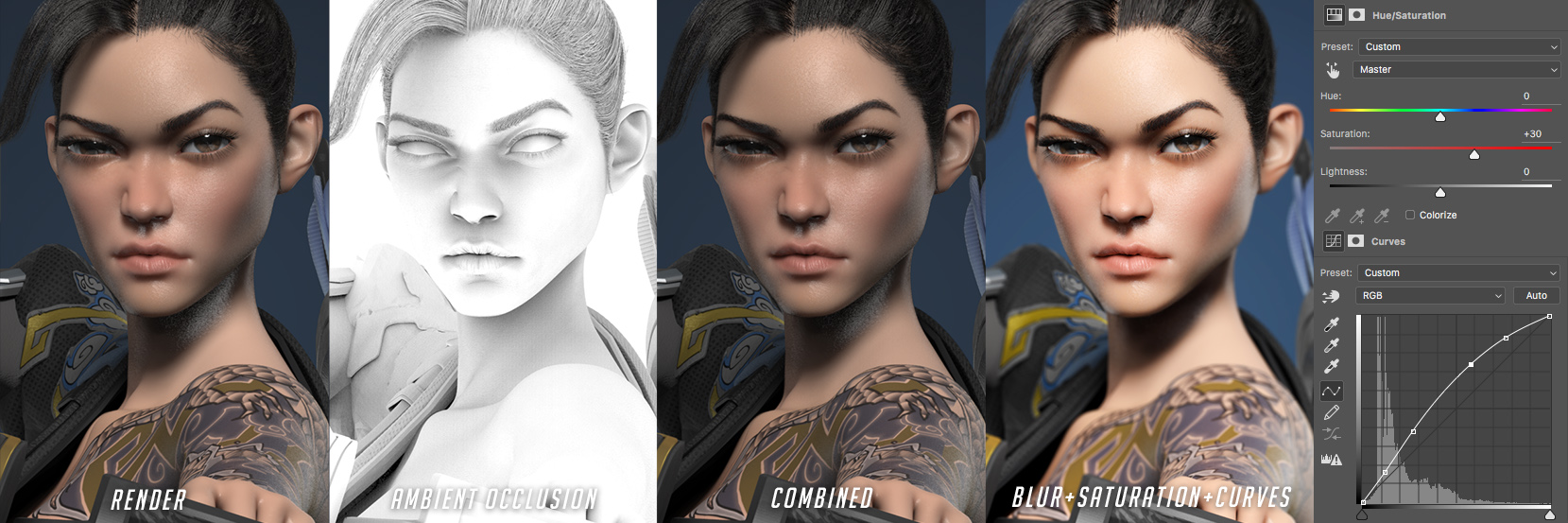

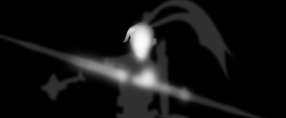

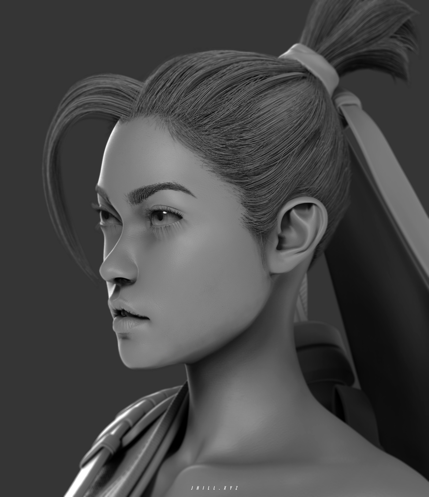

Then there is the rendering and compositing. I rendered two passes, a beauty with everything and an ambient occlusion pass. The ambient occlusion is achieved by assigning a matte white material to everything and selecting the pure white environment. I rendered these passes quite large so I could be free with the different compositions and final format of my images. It took about 5-10 minutes to render the beauty, the occlusion is much quicker. The translucent shader takes longer. In photoshop I added the finishing touches like a focal blur, vignette, and overall value and color improvements.
Here are the passes and post process
*special note, I found that disabling ground shadows in keyshot messed up all the shadows, so leave ground shadows on at all times.
