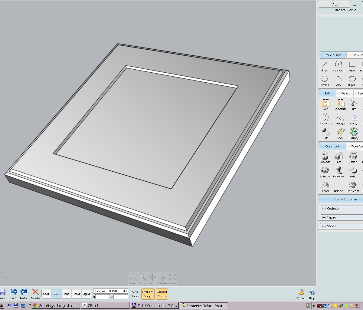

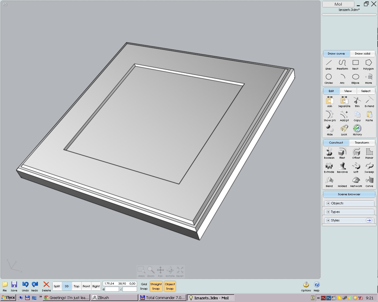

The basis I did in the program MoI, with millimeter precision. Then - export in *.STL format.

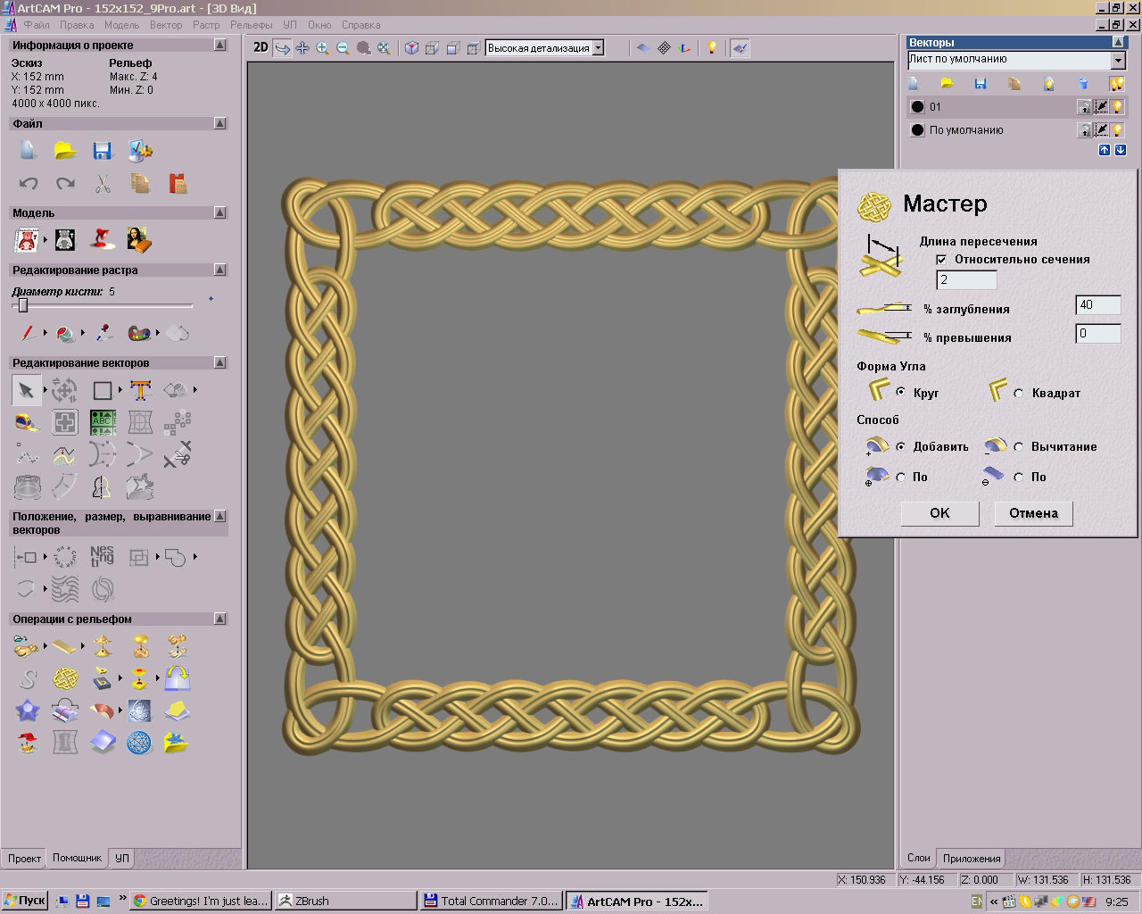

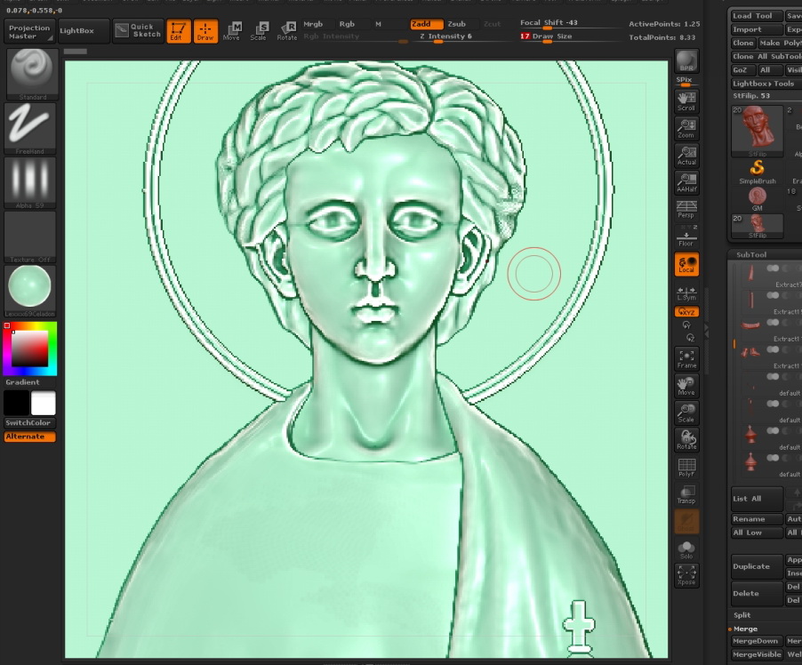

This piece I did in the program ArtCam. Then - *.STL. After that, all collected and sculpted in ZBrush.

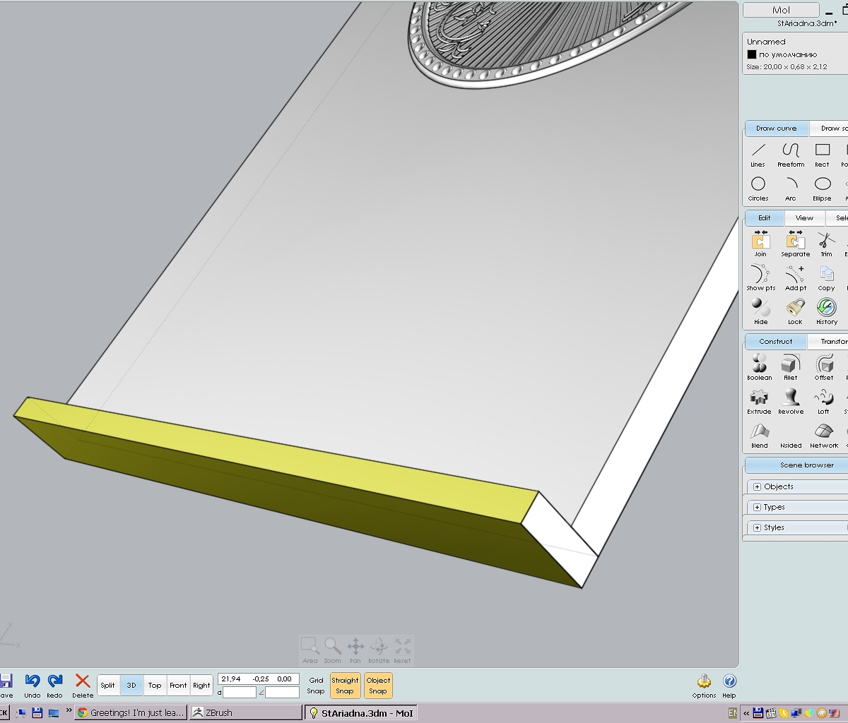

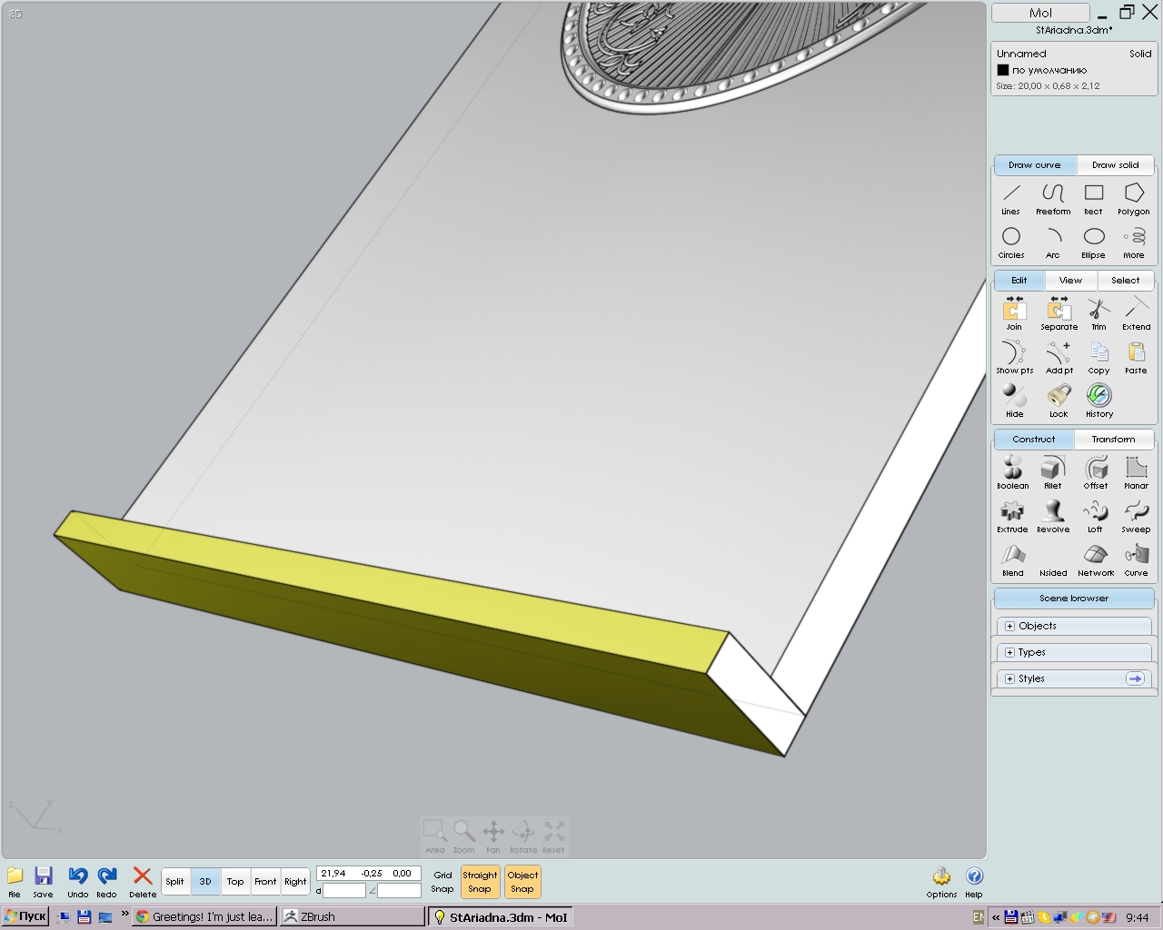

To control the height of the bas-relief I create an additional tool.
But it is somewhat approximate. If the customer requires strict relief height (in mm) I work with layers in ArtCam.
