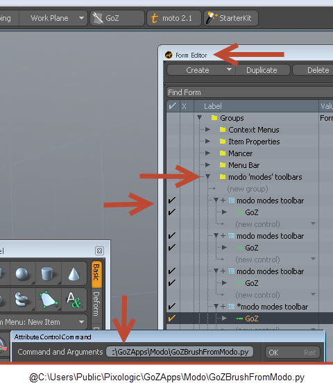

hi - just installed 701 windows 7 64 bit and found again the GoZ button was not showing up in none off the modo views. ( was the same issue with 501 and 601) i think this time the reason is that they have chnage the main menu mode.
but - easy to fix.
  1. do a forced reinstall from zbrush to modo 701
  2. open modo and from system menu - open “form editor”
  3. in form editor - open “groups”
  4. open the folder modo’modes’toolbars - inside there are 4 x blue marked forms - all the same - “modo modes toolbars”
  5. unfold the first form - or just select it
  6. in the form editor window - top leftthere is a “create” menue - click it a choose “new command”
  7. a small window pops up - “command & arguments” - copy and paste this including the @ and confirm by ok: @C:\Users\Public\Pixologic\GoZApps\Modo\GoZBrushFromModo.py
  8. now there is a new entry inside the first modo modes toolbar - called “run script” but greyed out, click the text and enter GoZ
  9. right click the newly created GoZ command and chose dublicate - make 3 dublicates
  10. drag one duplicate GoZ command into each of the 3 empty forms underneath.
  11. you should now have a button called GoZ in the following modo views: all except set up and animate
here it works fine -
cheers mads

excellent, that worked, thank you dyepeche!
