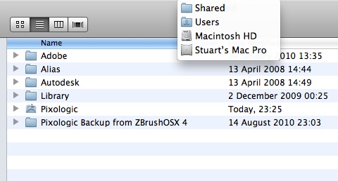

In your ‘GoZ_Upgrade_steps’ pdf Mac users are asked to navigate to ‘Users/Shared/Public/ folder’. I don’t have this Public folder (See image)!? What should I do? Thanks.mac_file_path_01.jpg
