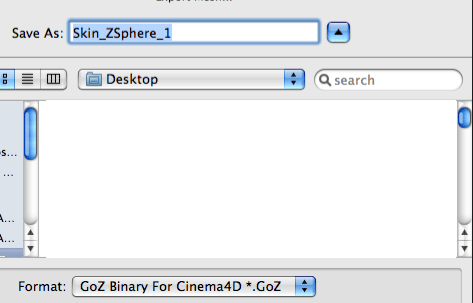

(posted also in Sculptris forum but as requested by Aurick in the Sculptris release thread to post here) I've set up all the GoZ prefs in ZBrush to see Sculptris but for the life of me after several reinstalls of GOZ and Sculptris following the procedure I cannot get Sculptris to send to ZBrush? Currently I feel positively bloodied , beaten and seeking a shoulder to cry on. Any tips of why I may still be having issues greatly received. Many thanks and if you have a sympathetic shoulder may I cry on it? Further info: "If Sculptris determines that the GoZ required GoZ files have not been installed you will receive an error popup" . I'm not receiving any such error message just no communication and [a whole lot of this](http://www.youtube.com/watch?v=rNVcSIZyBuE). Further to this issue I now get this dialog if I try and export any mesh as an .obj other than a default zool. Please advise the best solution. <!--[attach=258263]Untitled-1.gif[/attach]-->
Fixed my issue copied all my config files and brushes etc and trashed my screwed zbrush. Reinstalled ZB4 using the default GoZ and added the GoZ folder from the Sculptris application folder as directed into The GoZ app folder in > Users>Shared>Pixologic

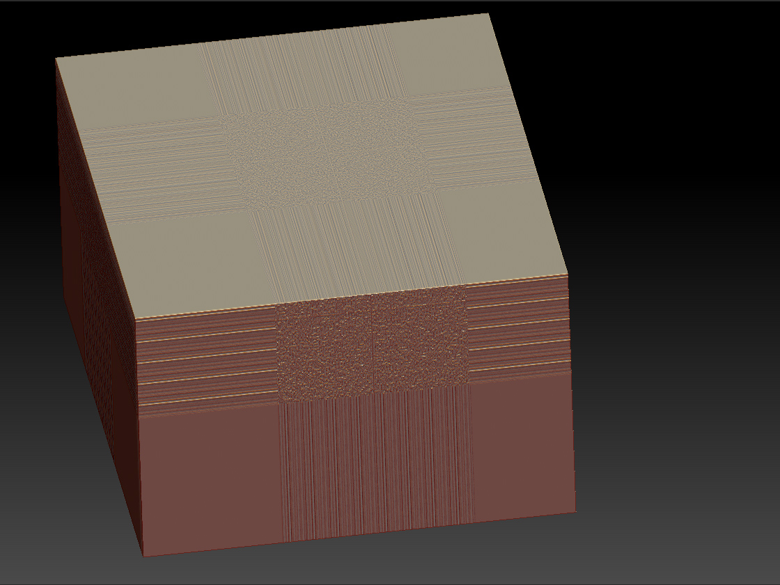

I’m haven some major issues with Goz From 3ds max 2011 to Zbrush, Sometimes It wont Goz all Meshes. The major issue is the Mesh gets distorted when I turn on Surface noise. As far as I know everything is set to Defaults and It was working ok 2 weeks ago. I’m haven the issue before A goz update and after, I even uninstalled and reinstalled.screwed.jpg
