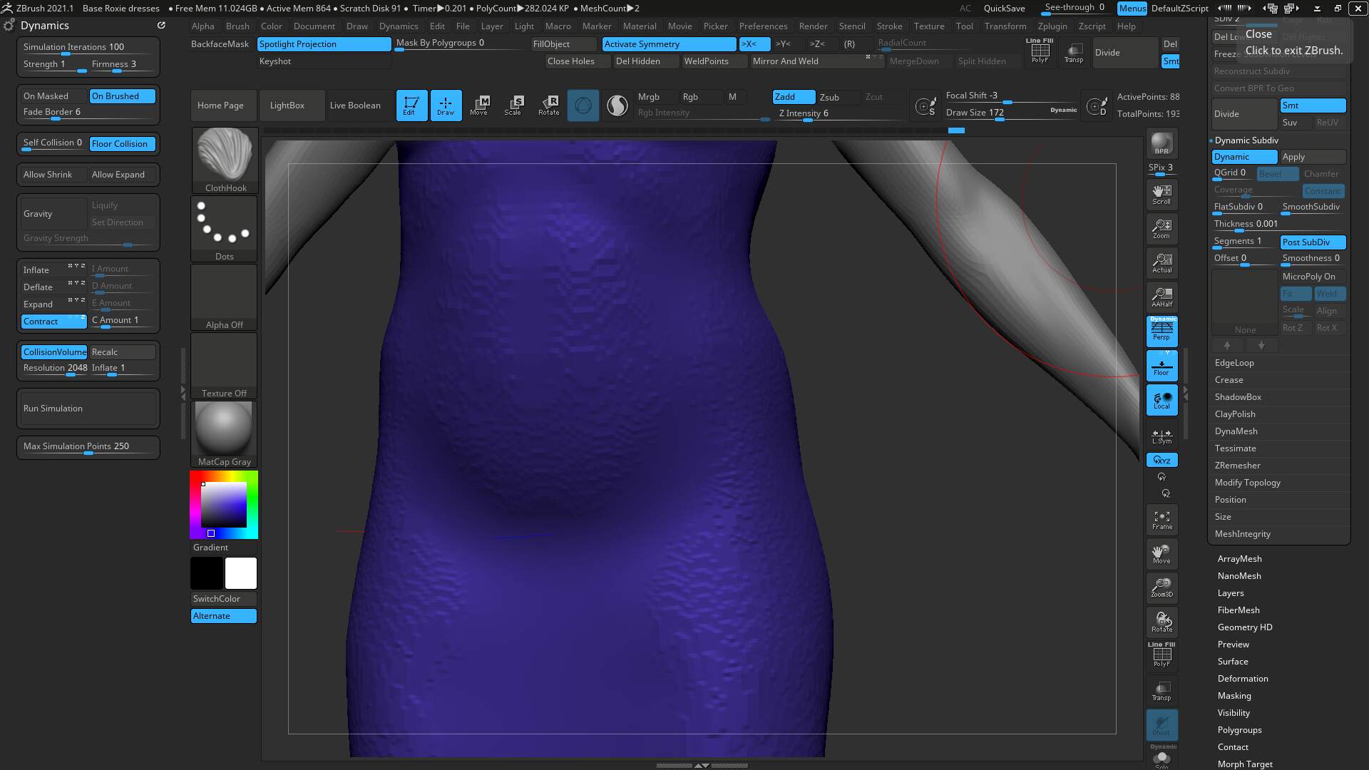

Hey all. I’m following along with Michael Pavlovich’s fabric Youtube videos for ZBrush 2021 Dynamic cloth.
One big difference between his results and mine: I’m getting a ton of what I can only call “Voxel static” when I use collision volumes, enough that it makes the fabric simulation practically useless. It’s a series of squares like lines on a topographic map that do not exist in the underlying mesh, but that immediately appear as soon as I try to run a simulation or use cloth hook with Collision Volumes turned on, almost as though the voxel computations that ZBrush uses for many things (like Dynamesh for example) are being embossed into the surface of my mesh. I’m an experienced user, and have monkeyed with a lot of settings, but nothing seems to get the squares to stop appearing. The squares are made up of the mesh of the dress, but like they’re being pushed straight in from the planes of a surrounding cube rather than being allowed to rotate to match the underlying collision volume.
Any insights or ideas on how to make this stop? At this point it’s more practical to just sculpt the fabric by hand because the smoothing required to remove the texture destroys most of the simulation anyway.

Thanks for the reply.
The Size is a good thought, it was at like 2.8, but nope, setting it to 2 has no real effect.
I’m using the same resolutions Pavlovich is in his demo, same settings, different results, and various tweaks along those lines don’t change much. The program’s first response on simulation or even first touch with the cloth hook is to generate voxel static all over, not even confined to the areas I’m actually touching with the brush. Again, only while using collision volume.

Thanks for all the replies- as followup:
Just taking the Resolution to 3200 has no real effect on the phenomenon, good idea to try though.
Remeshing the dress to 22,000 points didn’t stop the phenomenon, but did make it “blurrier” and the lower res is easier to smooth without destroying the work the simulation has done. Still very lumpy/staticy overall.
Remeshing the underlying figure to 26,000 points as well as the previous two fixes still leaves an oatmealy texture to everything, and creates raised artifacts along edgeloops, but is easier still to fix with a quick tap of regular smooth. Smoothcloth cleans it up somewhat in areas that are pulled “taut” but also generates new static within the new folds and “compressed” areas it creates.
Remeshing the dress to 10,000 points mostly removes the issue.
Remeshing the dress to 5,000 points eliminates it entirely, and Dynamic SubDiv gets back to the high res detail I was shooting for really quite beautifully.
A SmoothSubDiv setting of 3 was the best compromise between quality and processing speed on my system.
So yes: It is a phenomenon exclusively of higher resolution meshes, and the new system does indeed work best with minimum mesh size + Dynamic SubDiv making up the difference.
