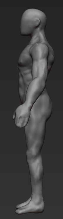

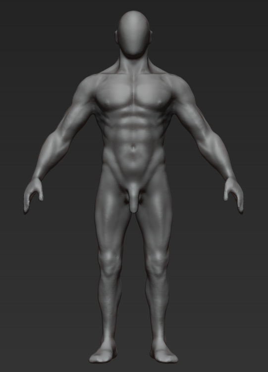

I’ve decided to spend this month focusing a lot on Anatomy so I started an anatomy study
Doing some more anatomy work today
Still trying to block in basic forms and proportions before going into real detail
Hi George,
It looks like your arms are a bit too long. I would suggest that you use the head length to measure your anatomy elements. There is ton of examples on google.
Here is mine
Hey Air0ne!
Thanks for the feedback! Yeah between the first and second post of that anatomy dude, I adjusted his body to meet the 8 heads measurement but you’re definitely right about the arms. I’m always unsure where they should measure out to (especially in a pose where they’re angled out a bit.) I think I measured them out an extra head
I will go back and make that adjustment when I work on him again

Here is a good page describing arm and hand proportions.
In addition, the easiest way to establish good proportions is by placing olecranon somewhere at the level of the last rib (basically at the waist). And the wrist should be at level of the great trochanter or pubic symphysis. If my model’s arms are not straight down but on angle I measure this distance with vertical Transpose line and then just rotate it to fit the limb.
I should admit that for my girls I prefer making slightly tinier arms and hands (slightly less than canonic 3.5 heads). But for males this method should work fine.
Thanks Vir Norin! That’s an awesome reference and good stuff to keep in mind. I’m going to remember that from now on
Also great idea with Transpose. I’m just now getting used to using it as a measuring tool and it’s really freaking convenient. Can’t believe I didn’t realize that sooner.

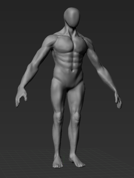

Here’s some more updates to the Anatomy guy. Shortened up the arms a bit and made some other minor changes. Didn’t have a ton of time tonight but I’ll do more work tomorrow
Upper torso looks relatively fine to me. Though Pecs look separated from the arm. I would rework the clavicular portion of Pectoralis and integrate it better into the shoulder. Distally this head inserts to Humerus slightly above Deltoid’s insertion.
The bottom part looks less developed. It appears like this guy skipped his leg day. Thighs and legs have very important set of high-points arranged in zig-zag manner. Without them the silhouette will look lifeless and boring.
Also you really need to add at least some indication of the genitals. It is amazing how many artists feel ashamed to sculpt them. They don’t need to be super detailed but they should be blocked out since they change profile and visually affect the thigh length. Or sculpt it with simple underwear…
Another most common mistake is to join the inguinal ligament line with the thigh line. This visually separates the thigh from the pelvis and looks really odd. These are separate structures. Inguinal line goes from ASIS to Pubic symphysis above the pen1s while the thigh line emerges from the crotch and goes three fingers width below ASIS, vanishing laterally.
But before you start implementing all fixes, pay more attention to posture and silhouette, especially in the side view.
Good luck!
I really love the detailed feedback Vir Norin
Thank you so much. I incorporated a bunch of your feedback into this next pass. A lot of the elements are still roughed out at the moment. I’m still planning to go into each area in detail. I was mainly trying to get main forms and proportions and got a bit carried away as is easy to do with this stuff lol but I’ll keep posting updates as I do the more focused areas
