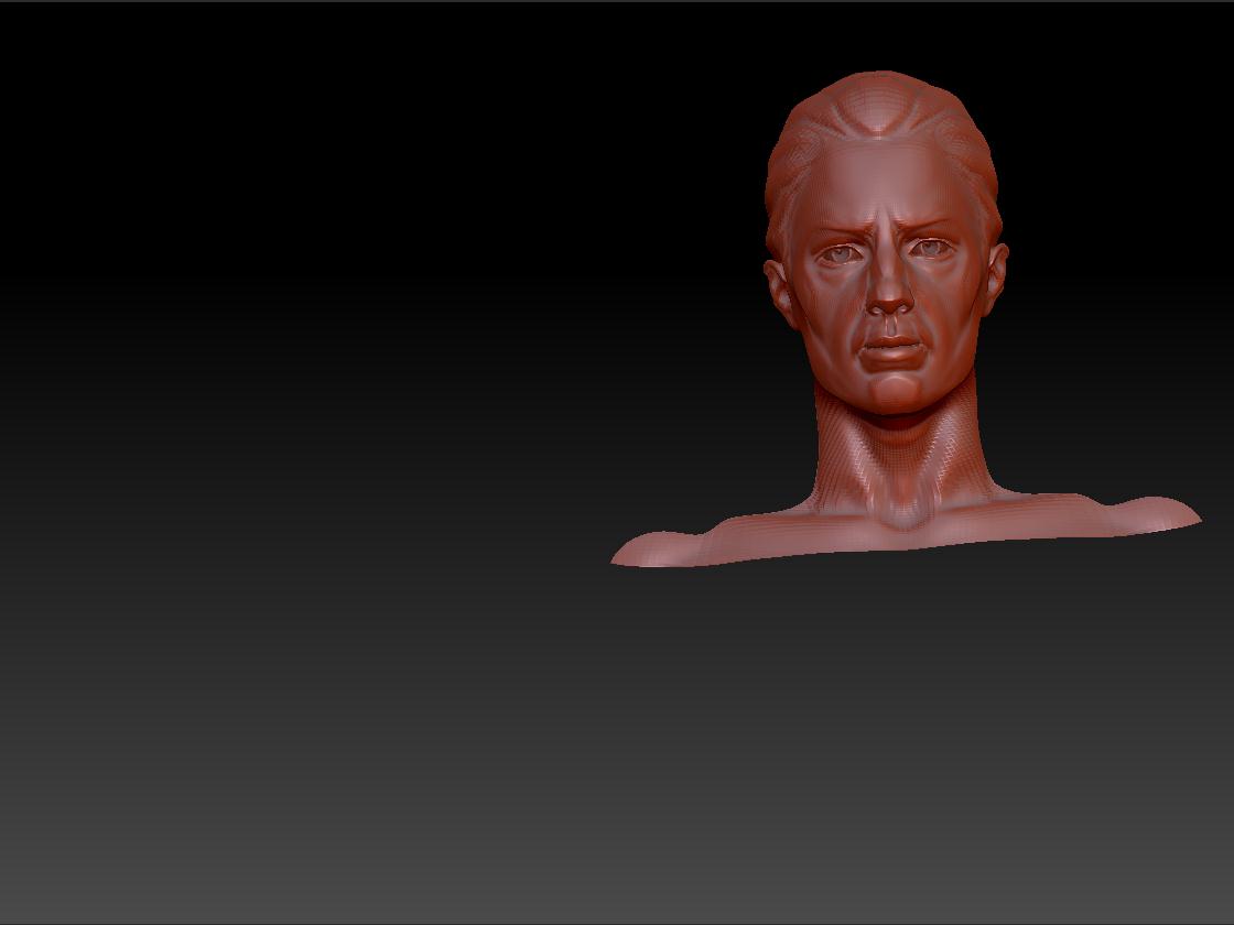

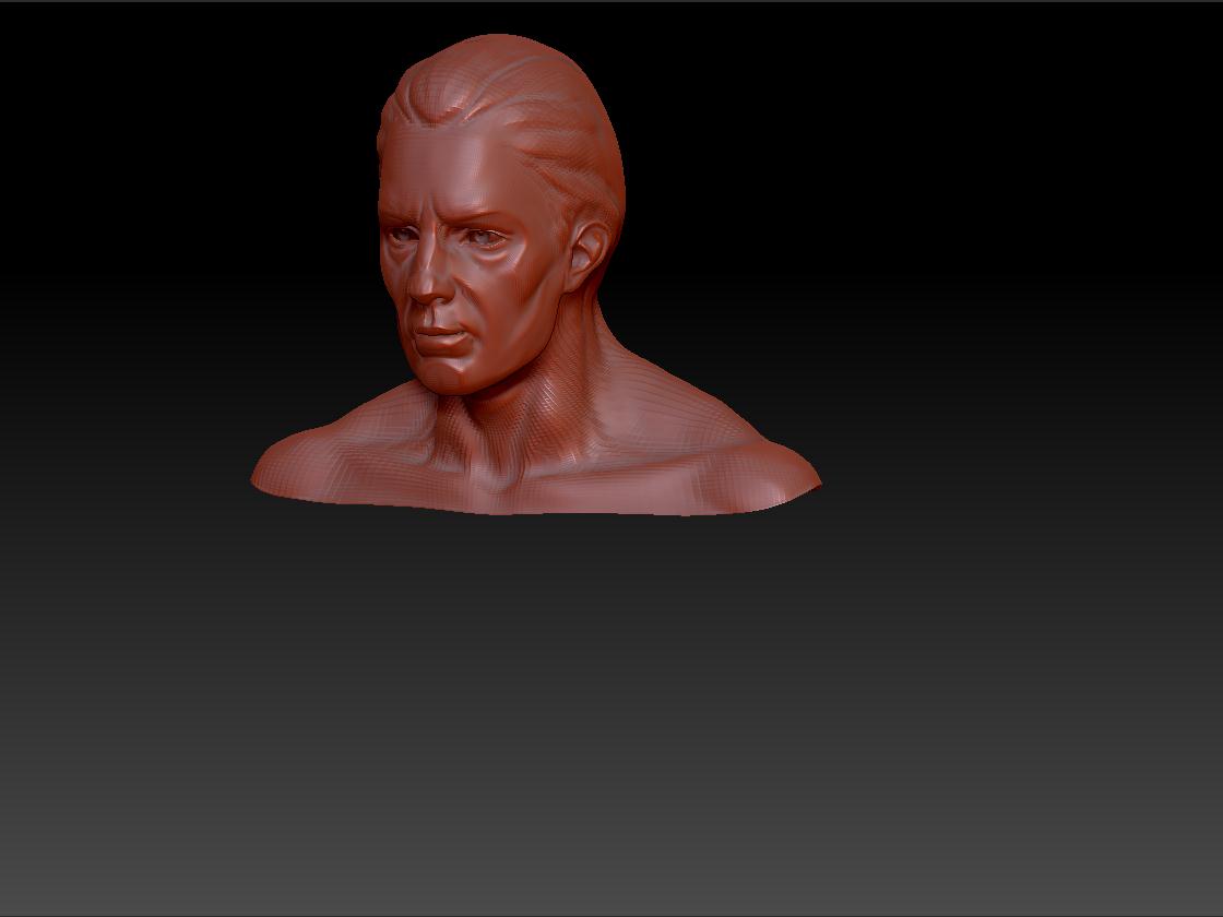

Ok the top image is after i rotated/move the tool off the background. The bottom is what happens the second i move the tool anywhere on the x/y planes afterwards.

just discovered something…dont know if it will help anyone figure out what the problem is but here goes. When i click on the gizmo to move the head, if i click on the 4 quarters inside the sphear so that i can freely move the head anywhere it does the auto rotate/sink into background thing. If i use the very top/bottom/left/right sides that constrain it to x/y movement only it does not auto rotate/sink back
