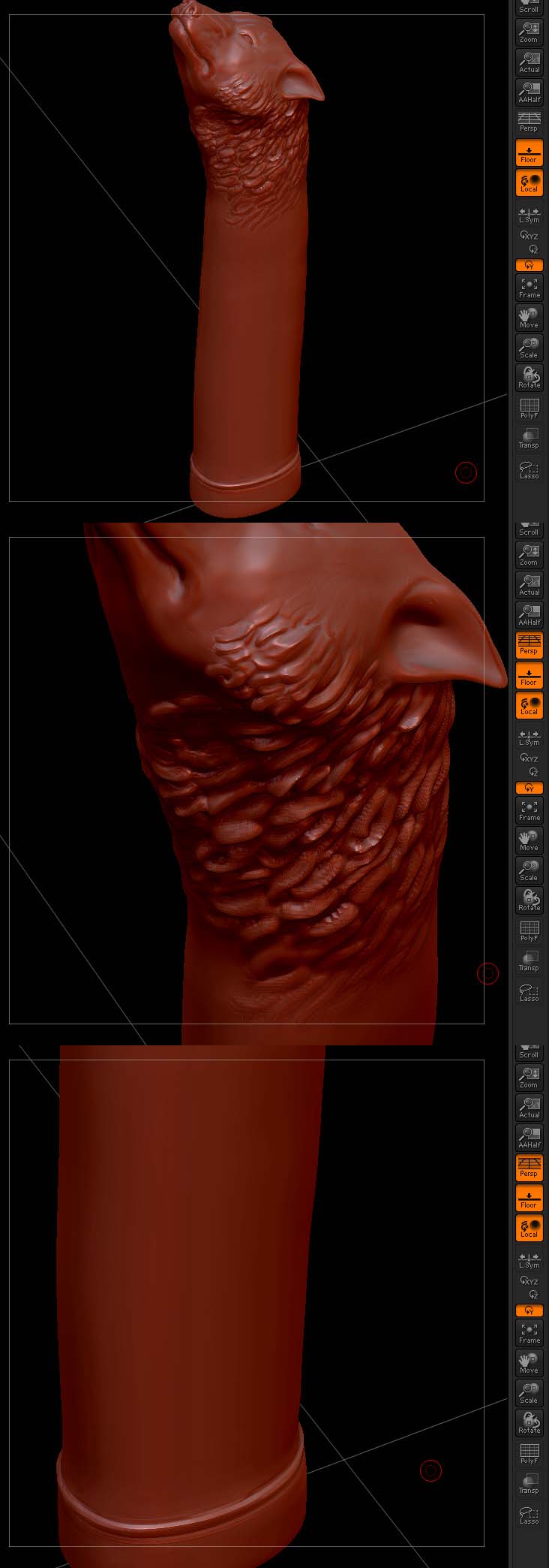

when i press f to fit my sculpt into the view it won’t always fit the entire model or sometimes it even moves it entirely out of the view depending on the angle and even the same angle can give several non fitting views of the object.
this is both with the align to object option on and without
the object i have noticed this most with is this long katana
only got one single subtool in the example below and did not change the angle for it at all
[framebug.JPG]
My boss and I are getting this same issue. We did change our interface layout, but that was it. I don’t think that would be related.
samething, it’s very annoying :frowning:
Press F twice. First press, frames subtool, second press frames entire model. At least it’s how is working here with me.
yeah actually i dont have this same problem anymore since r2, but it still cuts off the top and bottoms of my models, as in it frames it just a little to large to fit…
It does not matter how many times I press F. Sometimes if I hold down F, it will eventually center. Other times it will never center. Usually happens when I have partial mesh hidden. Happens on my work computer and home PC.
