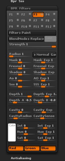

Here is a quick capture of my bpr filter “fog” settings, maybe they can be of some use to you:
it might not be clear from that image, but F3 is the only filter I have turned on as by default it is set to sharpen, and i never use that one, but I think any of the filters can be set to paint.
Usually takes a bit of experimentation with depth A and depth B to get it right.

This is interesting!
Thanks Im going to go try this out right now!
Thank you!
