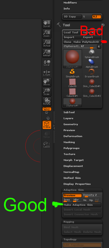

Whenever your using the topology tools and you use the make a poly mesh button (RED button in picture) you will get flipped normals.
If you use the green you will get good geometry.
So at one point out coming out of the topo tools workflow if you used red somwhere in your workflow. You will run into alot of problems down the road.

you know jason i saw you post this the other day, i was going to repost it here, but he said adaptive skin so i just figured it wasnt that. i honestly don’t know why someone would make a skin through the makepolymesh3d from retopology anyway, but for you to know this means that people must be doing it often, strange.
Ya its a weird quirk

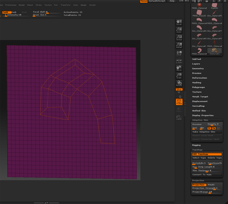

If you make a single sided object by laying your topology on a flat plane. hit A and hit the red button You can watch it flip the normals;)
Like this
