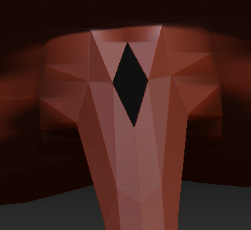

Problem: I have a hole in my mesh. How do I cap, or fill or weld it within zbrush?
I started my model in 3ds Max 09. Working on half of the model I used a symmetry modifier then collapsed it to a editble mesh and exported .obj. (Max09 users see this thread if you have trouble exporting obj to zbrush http://www.pixologic.com/zbc/showthread.php?t=60565) I opened my obj in zbrush, subdivided it to 3 levels and started sculpting. After a while I noticed a small hole in the back of the mesh. I must have had a pesky little vert too far from the seam in 3ds max.
To fix this in max would take about 5 seconds - simply weld the vert. i know i could export back out to max and do this but I’m trying to learn zbrush. This is where I find zbrush frustrating to learn at times. The solutions I found http://www.wonderhowto.com/how-to/video/how-to-fix-a-hole-in-a-mesh-in-zbrush-3-1-184393/ , http://www.pixolator.com/zbc/showthread.php?t=46455, (amongst others) seemed rather complicated for such simple problem.

The reason this isn’t a “simple” fix in Zbrush is it isn’t a modeling tool. It is a sculpting tool. They are two totally different mind sets, hence what seems like a dumb way to work to you, but a very logical way to work to me.
anyway, to weld that edge together. use the piinch brush, mask off everything else but the 2 verts you want to move. Grab the pinch brush and hit it hard so the two points are sharing the same space. Then export out and obj. make sure “grps” is turned on in the export panel in the tool pallette. switch to the simple brush, clear the canvas, import in the new one, making sure that “weld” is turned on in the import panel. you may have to adjust the level of the weld depending. you are going to loose all of your detail, if you have sculped any though.
and also, do a boarder check in max before you export. save the headache.
