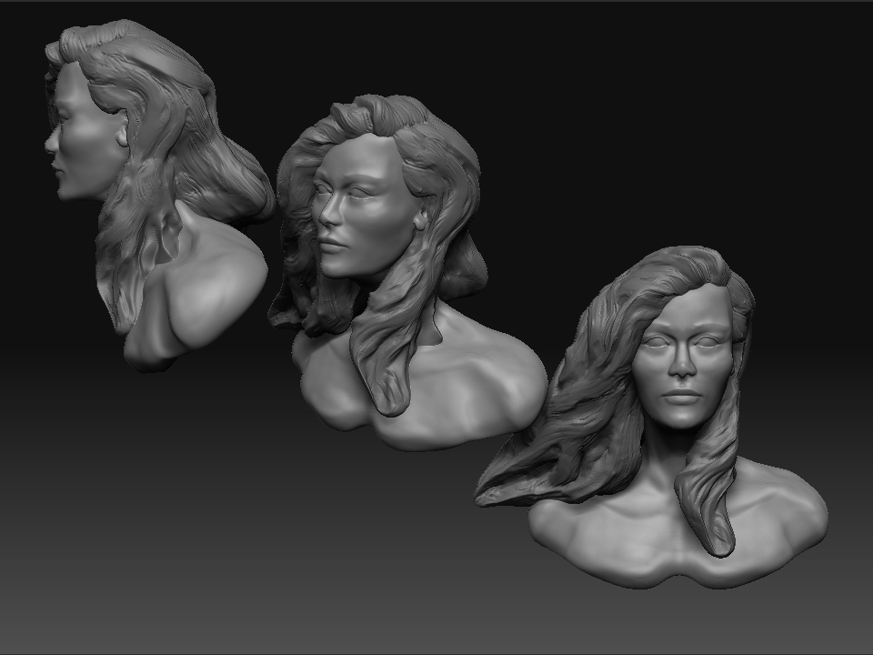

hi everybody
i need some help again :slight_smile: i am watching Ryan Kingslien tutorial for the female bust and… i got stuck here it is just keep looking very male instead of a female. i tried moving stuff around making the lips bigger and a lot of other things but no effect. so… would some take a look and suggest where do i go from here. Or is it easier just to start all over again! What would be a good book to get to learn more for human faces? or onother tutorial.
thanks in advance
[attach=135713]bust.jpg[/attach]
There is no need to start over. I think you learn much more from sticking with it and trying to get it right.
By far the biggest male characteristic is the square jaw. You can see this clearly in the side view. Woman dont have a “corner” but instead a nice smooth rounding to the jaw.
Like this: http://artfiles.art.com/images/-/Keira-Knightley-Photograph-C12118073.jpeg
She also seems to have a bit of a large nose. While this is not a rule set in stone woman generally appear to have a bit shorter noses.
Apart from that there is the eyebrow ridge. This is something that is almost never as emphasized in woman as it is in your sculpt.
Here is an example: http://www.intuitivmedia.net/data/picture/detail/726.jpg
See how there is hardly any bump? Better to have no bump then too have too much there.
I think those things will help. But woman faces are hard. :slight_smile:
GrtZ 3dioot
this is exactly what i wanted. thanks man. just by experimenting i could not get it right and i needed exactly this. i did not actually expected someone to help me with this one because it is just … i know i have to try it by myself. thanks this is very nice of you to attach and examples.
i cant continue with it now but i will tomorrow. cant wait.
have a good day

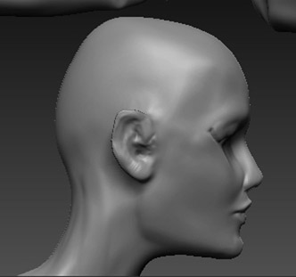

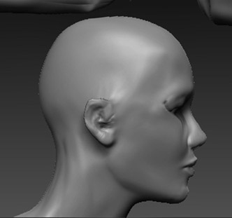

hello disanski,
your model looks just fine from the front view, the problem appears on the other views.
Beside 3dioot suggestions, you can try with this arrangements I’ve done in photoshop.
I hope it will help.
good luck, and have fun :slight_smile:

thank you very much for taking time and fixing her up! i see you made the neck larger and the ears smaller and you move the whole chin backwards a bit and you also fixed the corner on the back of the jaw. the top of the head as well. Thank you i am gonna try to do it myself now.
so it took me a while it was not as easy as i thought :slight_smile:
here is it again and i tried to fix what you guys advised me to. so is it any better? what else could i fix? are the eyebrows still a bit to far out?
[female_bust.jpg](javascript:zb_insimg(‘136161’,‘female_bust.jpg’,1,0))
wow, much, much better, I would move eyeballs more deeper( but that’s just a question of taste :slight_smile: ), and maybe smooth the transmission between nose and cheeks.
Great work, keep it going :slight_smile:
thanks man. i will smooth that. by the way i love your runner and the girl as well! have a good evening
Hey Disanski, this has improved a lot. It’s looking really good. I would soften the transition beteween the nose and the chic like Koyazzman had mentioned.
Keep zbrushing. :+1:
Yes! Great update! -She- looks much nicer now. See how it would have been a waste if you would have started over? :slight_smile:
      Now its time to really focus on facial structure/proportion though. As koyazzman said the eyes should be deeper set into the face. I dont think its a matter of taste though, eyes are never as far to the front as they are currently on your model.
