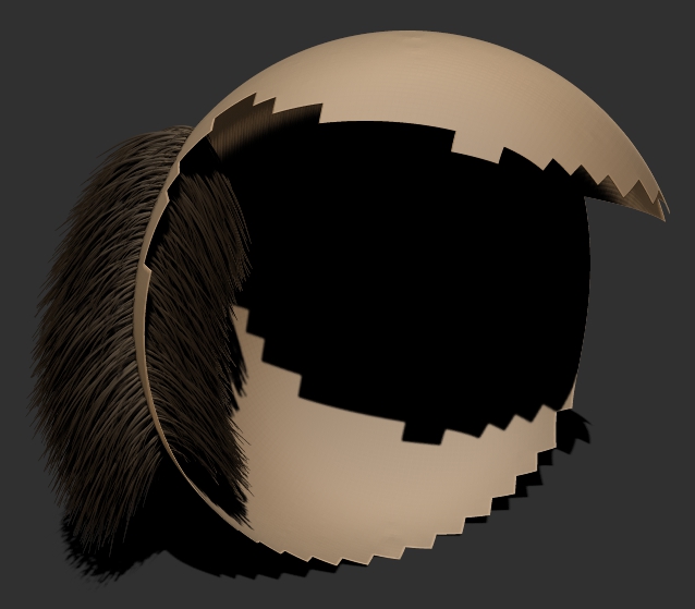

Thanks for the reply, but I’ve tried this. For clarification, please see the attached render:
Here you can see a polysphere from which I’ve deleted some faces. I’ve applied a mask to part of the poly shell, and have run fibermesh. The issue that I’m having is that the fibres appear on the inside of the mesh; you can’t use backface masking here. because there are no other faces to effect. The hairs traverse the 2D topology of the poly shell; this happens no matter what settings I use for ‘Imbed’. All ‘Imbed’ does is vary the degree to which, in the example shown above, the hairs move towards the convex or concave, but no settings that I can find can actually just make the hairs grow out of the exterior, or convex, aspect of the topology.
The above example is with a 2D topological form. If I give this shell of polygons thickness, it makes no difference, and no matter what masking settings I use, I still get the same error. This is the same with the coat that I’m trying to cover too.
I can’t believe that I’m unable to completely prevent hairs from growing on the inside of an object… am I missing something?
Hmmm I’ve tried this on the jacket again, and actually it’s not a problem anymore. The current version of the jacket has thickness to it, and it works fine… this wasn’t the case yesterday, so maybe zbrush just needed a restart :rolleyes: lol, I should have thought of that first
Thanks anyway, everyone
Let me explain what is happening in the image you posted above. You had Display Properties > Double turned on when you activated the FiberMesh > Preview button. Make sure Display Properties > Double is turned off before you activate FiberMesh > Preview. After you activate FiberMesh > Preview, you can turn on Display Properties > Double and the FiberMesh will only be on one side.
