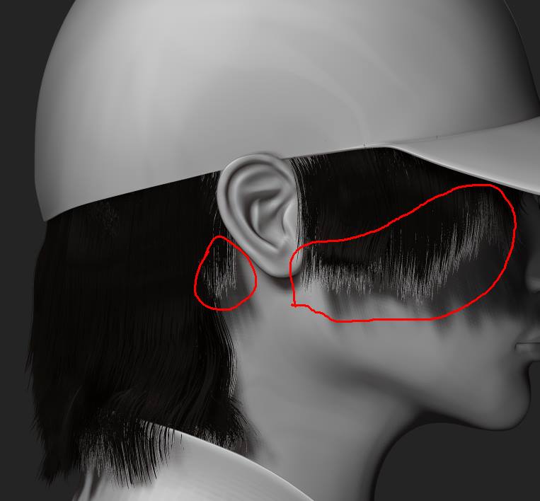

Hi guys, I’m having this problem with fibermesh when I BPR. I get strange white tessellations/artifacts along the edges. I’ve tried several different settings and materials i can’t seem to fix it. Anyone have a solution?
When you were setting up the fibermesh, were the root and tip colours different?
Yeah they were. The roots are a near black brown and the tips are natural dark brown. Should i not be applying color to the root and tips during the setup of the fibermesh?
I have the same issue ! And I don’t understand where it come from too
sorry Horn.
I hope somebody will help us.
Has this issue ever been resolved? I can’t get rid of the white fringe when BPR rendering fibermesh.
Same question, has this issue found a solution yet?
If anyone is still having problems with this , you just have to increase the resolution of your document when you render.
