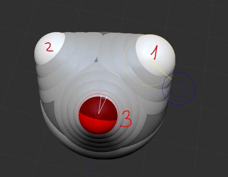

Maybe my example wasn’t clear, I’m not talking of creating a ZSphere on top of the previous one, as it works right now in ZB!
I’m talking of creating a ZSphere in other areas with the same radius of a previous ZSphere, something in this image, where I would like to have ZSpheres 2 and 3 with the same radius of ZSphere 1:
I hope it’s more clear now.
OK, I see what you mean now. Yes, that would be a nice feature.
