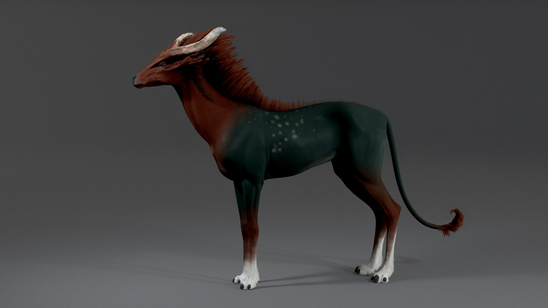

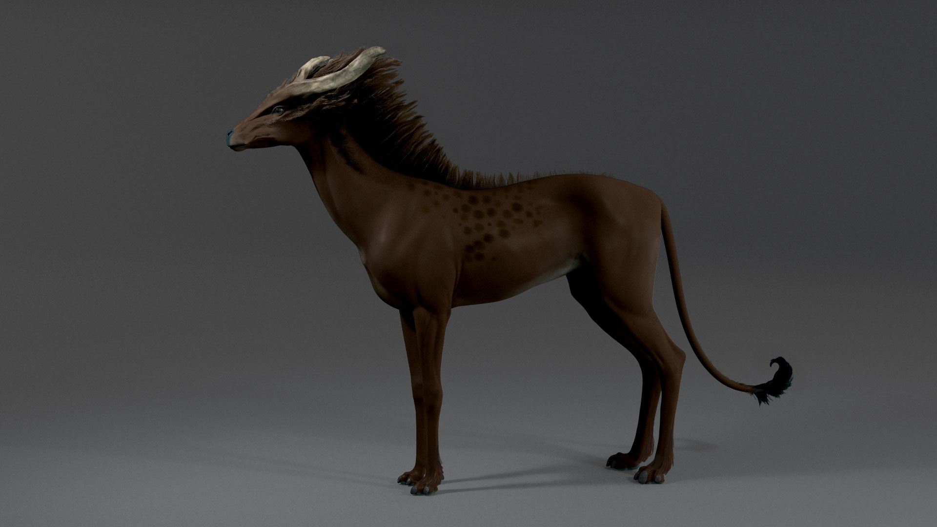

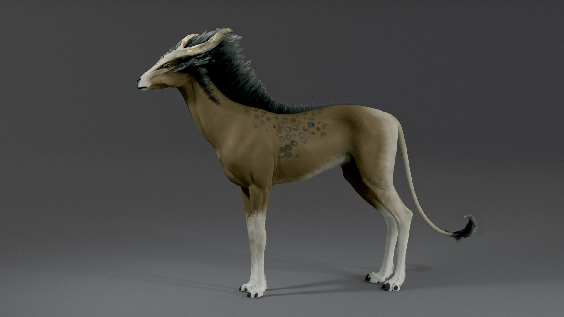

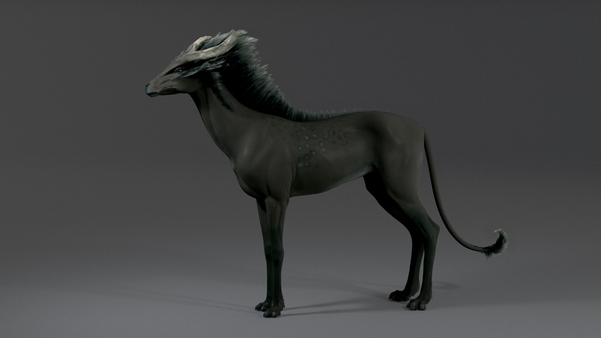

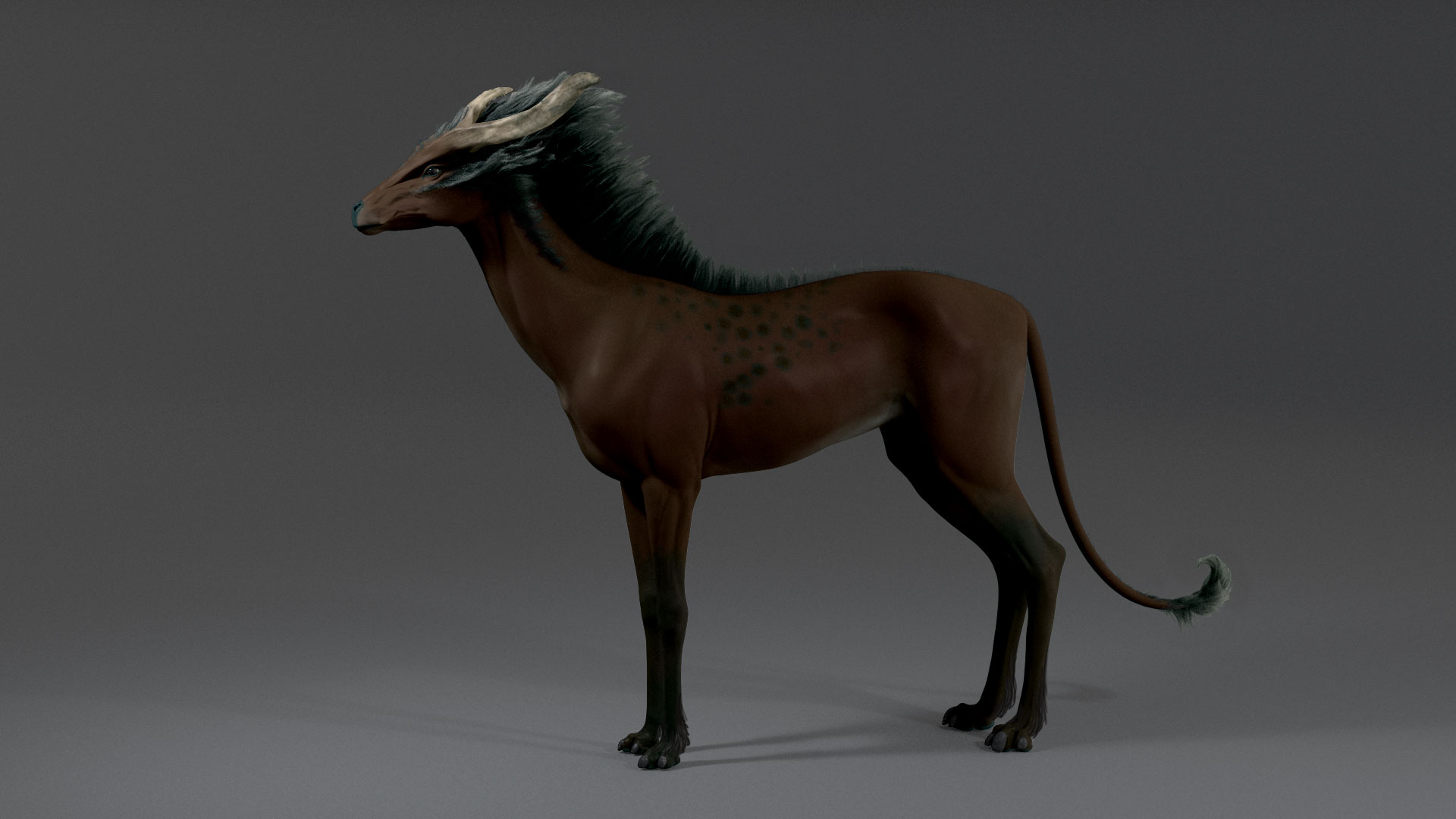

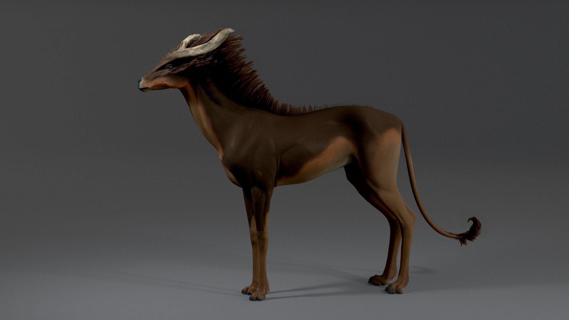

I recently got a hankering to produce a 3D version of a sketch I did while drawing with my kids. Below are some color concepts for it. These are paint overs on top of vray renders of a dynamesh’d version of the zbrush model plus xgen hair.
ConceptBaseRender1_CLR-Op2.jpgConceptBaseRender1_CLR-Op3.jpgConceptBaseRender1_CLR-Op4a.jpgConceptBaseRender1_CLR-Op4b.jpgConceptBaseRender1_CLR-Op4c.jpgConceptBaseRender1_CLR-Op5.jpgConceptBaseRender1_CLR-Op6.jpgConceptBaseRender1_CLR-Op7.jpg

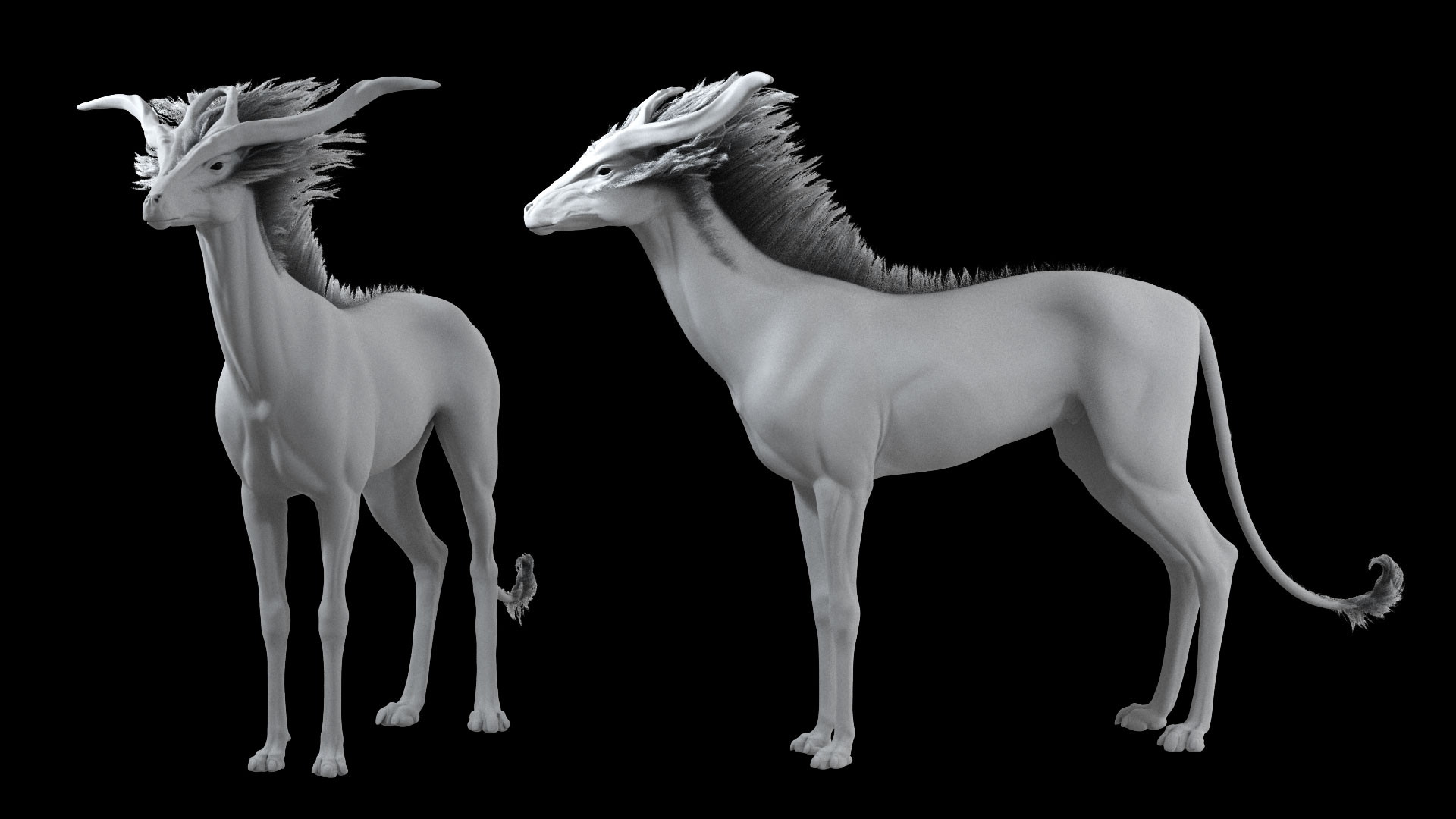

Grey Renders. Mostly to show a different view of the model.

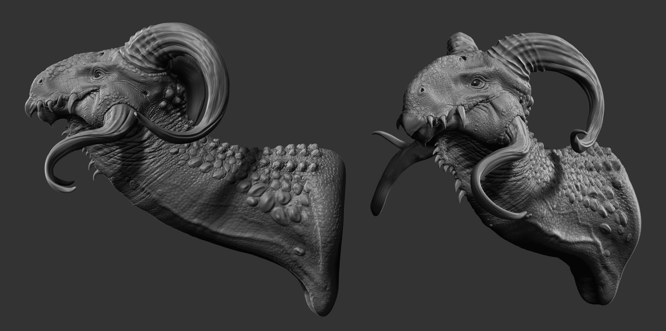

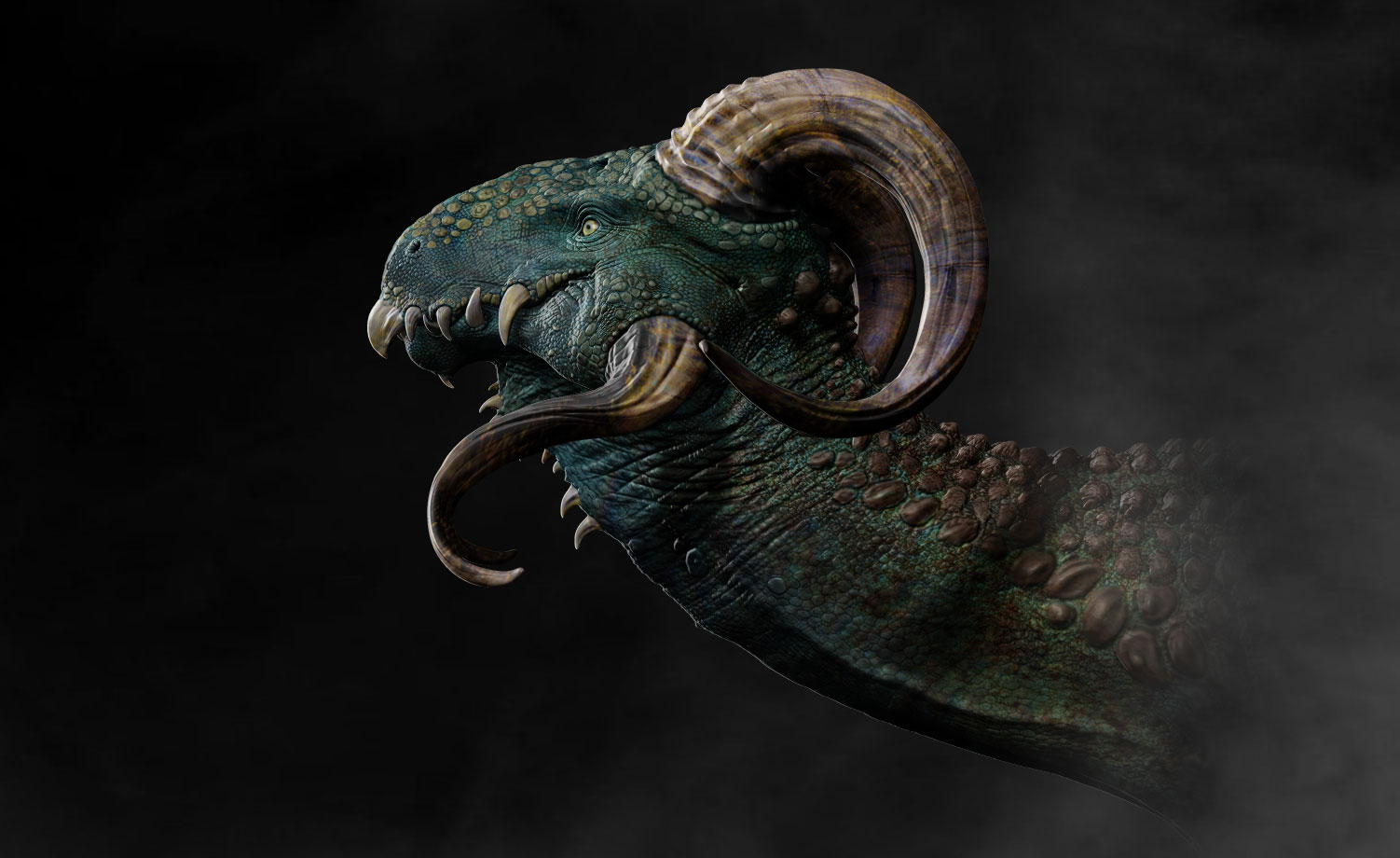

Some new stuff. The color image of the dragon is just a photoshop paintover on-top of a zbrush render:
