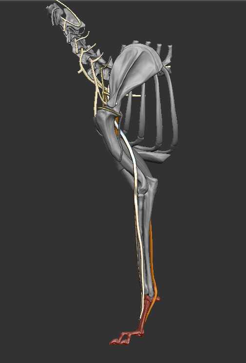

I have a Ztool that looks like this where I have filled different subtools with different materials:
materials
I would like to clear / reset the materials on ALL subtools to just use the currently selected shader, in preparation for rendering.

Hi @arumiat
You can use the “Fill” option in the SubTool Master plugin to fill all visible subtools with your current color or material or both. If there are some subtools you don’t want changed, just turn visibility off for those.
Yes, as @zber2 says (thanks zber2!) you can use SubTool Master > Fill. To “reset” the subtools so that they display the selected material, fill with the Flat Color material.
