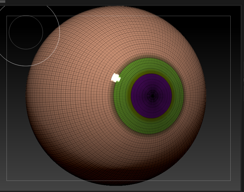

One alternate method I found easy to do for eyes is load the polysphere tool make it a polymesh and subdivide a couple times. Orient it so the concentric rings are facing you and turn off perspective. Mask out the iris first and make the mask a polygroup (polygroup by masking) then mask out the pupil in the iris and make that a polygroup. Then you can easily change materials and colors on the different polygroups or inflate /deflate the pupils for lighting effects, 3D printing etc. Just makes working with eyes easier. I’ve attached a pic of an eye I did recently using toy plasitc for the material. Hope that’s useful .
