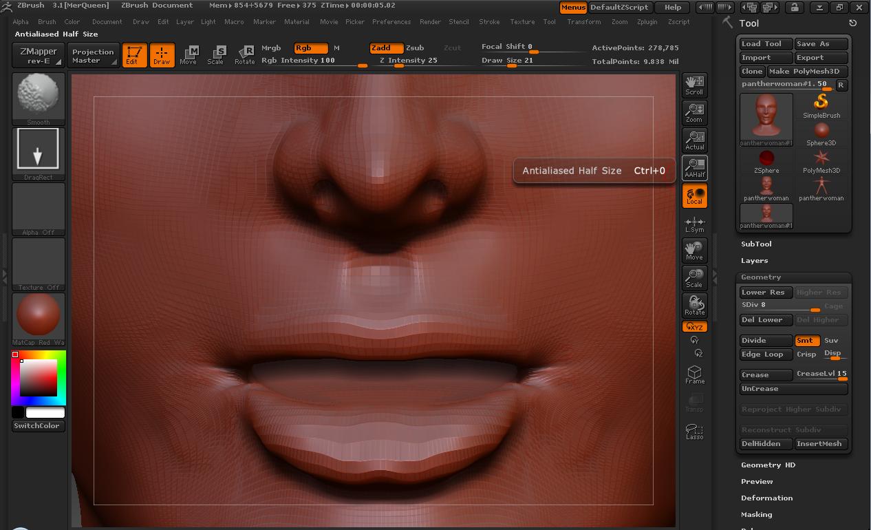

im also having problems with the face, but with the mouth- usually i have lips together- nothing to worry about, but now i want to make it so there is actually a hollow space for the mouth, then form the lips around that hole-the problem is, when i do that, i get these unshiftable creases around the side of the mouth
  • ive tried starting with lips together and separating them later on but that didnt work… so… is there a way of preventing that? or perhaps im doing things completely wrong?

@Papiea: You problem likely has to do with the subdivision level you’re working on, it’s probably too low. Traditional knowledge is to start building up parts in the lowest subD level you can, but the lips are often left to once you have a decent amount of polies to work with.
