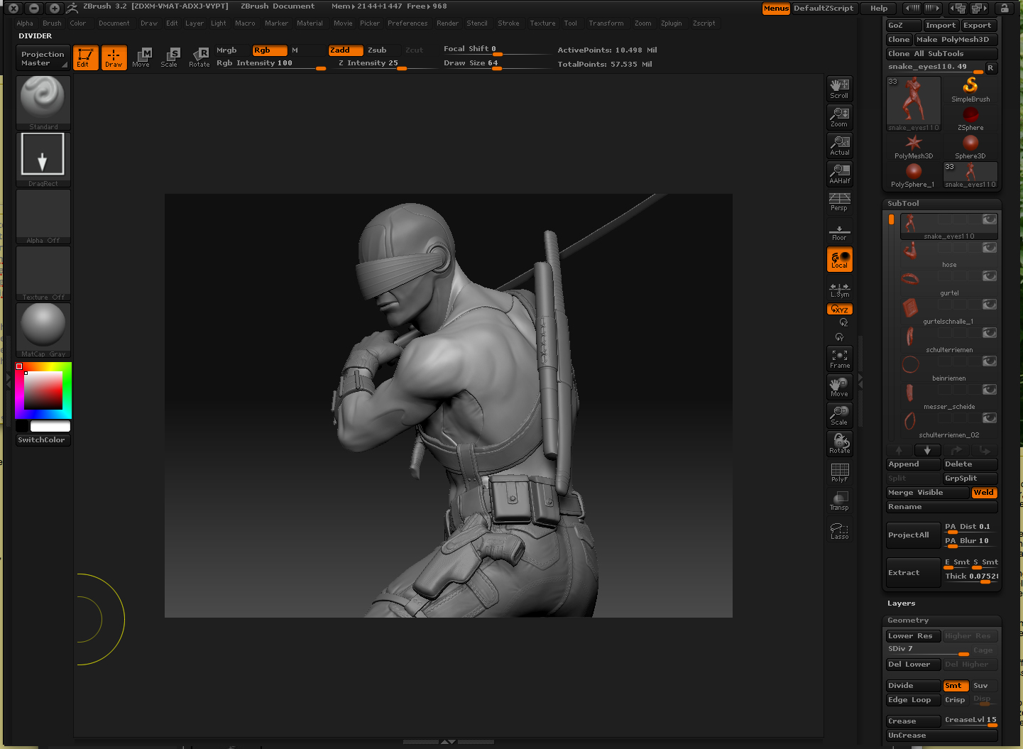

I´ve added a screenshot. Maybe someone can find there any wrong button or anything else, which I did wrong.

Did you increase your memory settings or up the max poly per mesh setting?
both are found in
preferences>memory
I don’t have 3.12 and I heard that on the Mac you can hit higher Polycounts per tool without the major slowdown you see in 3.1. But even with that I doubt very much that you can hit a 10million polygon subtool without slowdown.
Are you using Layers? Each layer basically doubles the file size from what I’ve seen. If you have layers on lvl7 (10mill) then each layer has to remember where all 10million points are on the mesh.
Having all of your subtools at their highest subD eats little bits of memory for sculpting. But for rotation that uses CPU and it has to process all of the points in the mesh when you rotate.
I recommend breaking up your two highest meshes into smaller subtools. I am assuming the 10mill mesh is the body.
To help on file size always save at the lowest SubD on all tools.
If you are using layers you can collapse the layers down and save them out as independ tools and import them again later if you need to edit them, or want to keep a different file incase they need to be edited or changed later for some reason.
Hmm…that’s about all I’ve got.

I have splitted now my large subtool #0 and deleted all those parts of the body, which I don´t need (hands under the gloves, legs under the pants, etc). Now I am down from 1.3GB to 700MB and it is a bit easier to handle.
After browsing some topics in this forum here I recognized, that there are a lot of users who got same problems but with less polys than I had. So I guess it was a mistake done by myself and not a bug of Zbrush or of my computer.
I am happy now to go on with the work on the figurine and I will search for more possibilitys to delete more parts.
