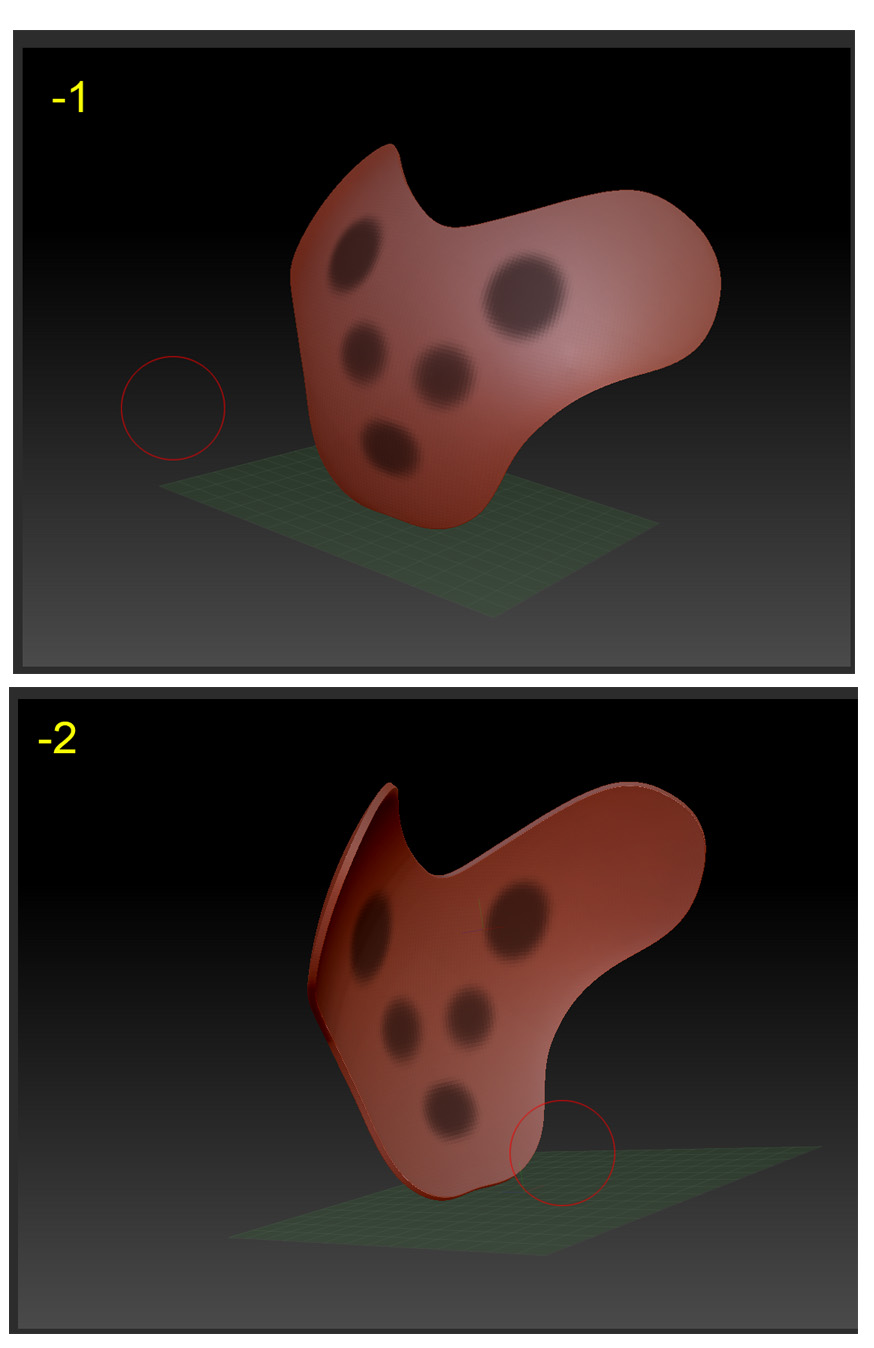

the problem is when I’m trying to mask a specific part of my mesh, the mask pen brush affect the other side of the mesh (picture-1 and -2) I want to Avoid that.

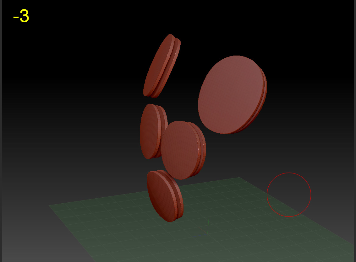

and because of that when I extract the mesh it ended up something like picture -3

brush.auto masking.BackfaceMask
Your mesh is so thin that your brush is grabbing both sides. Just turn on backfaceMasking (make sure you have your mask brush active, just hold ctrl when clicking the button).
Thanks man, It worked.
