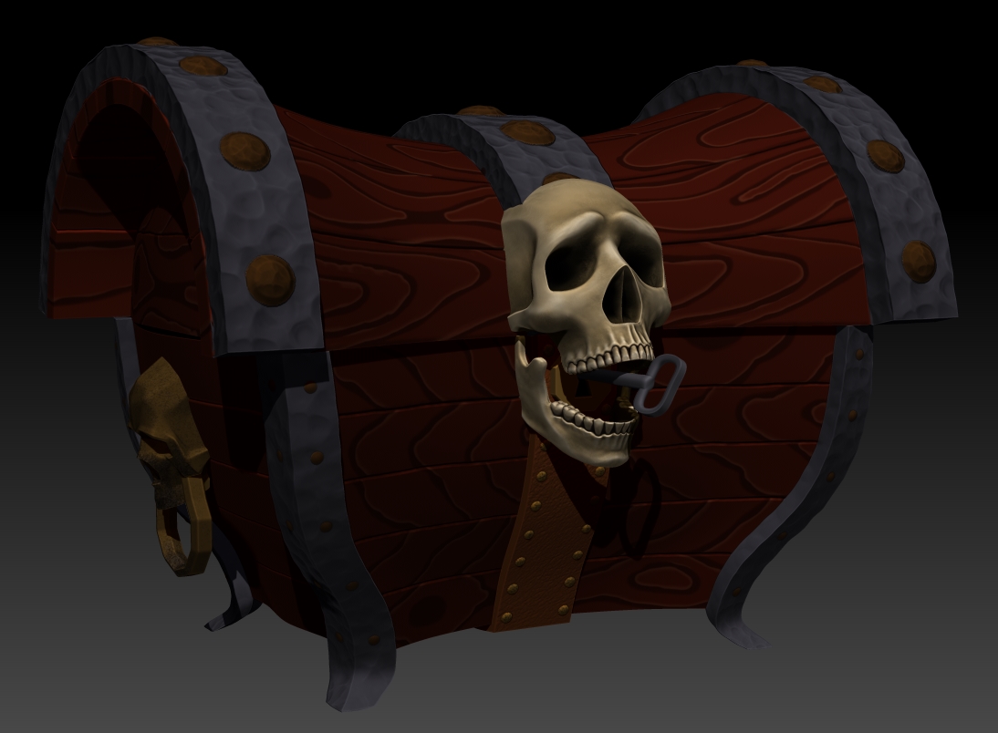

My problem: I’ve sculpted a low-poly treasure chest into a high-poly version, then tried to export it as a single OBJ. The result is a huge 3.4GB file for an ~18mil polys tool composed of 11 subtools.
