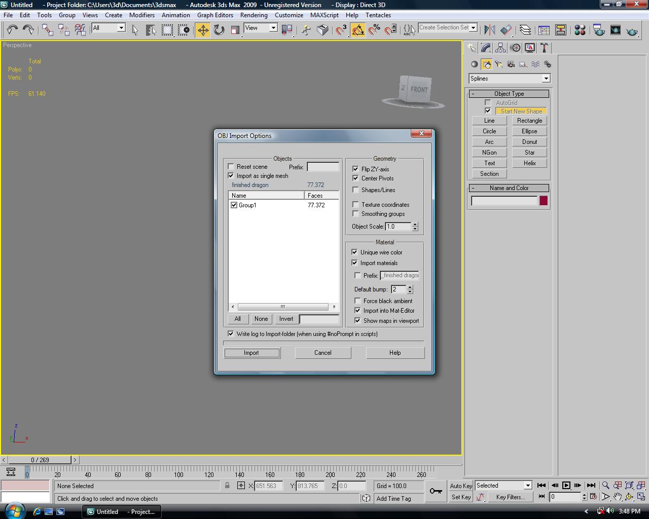

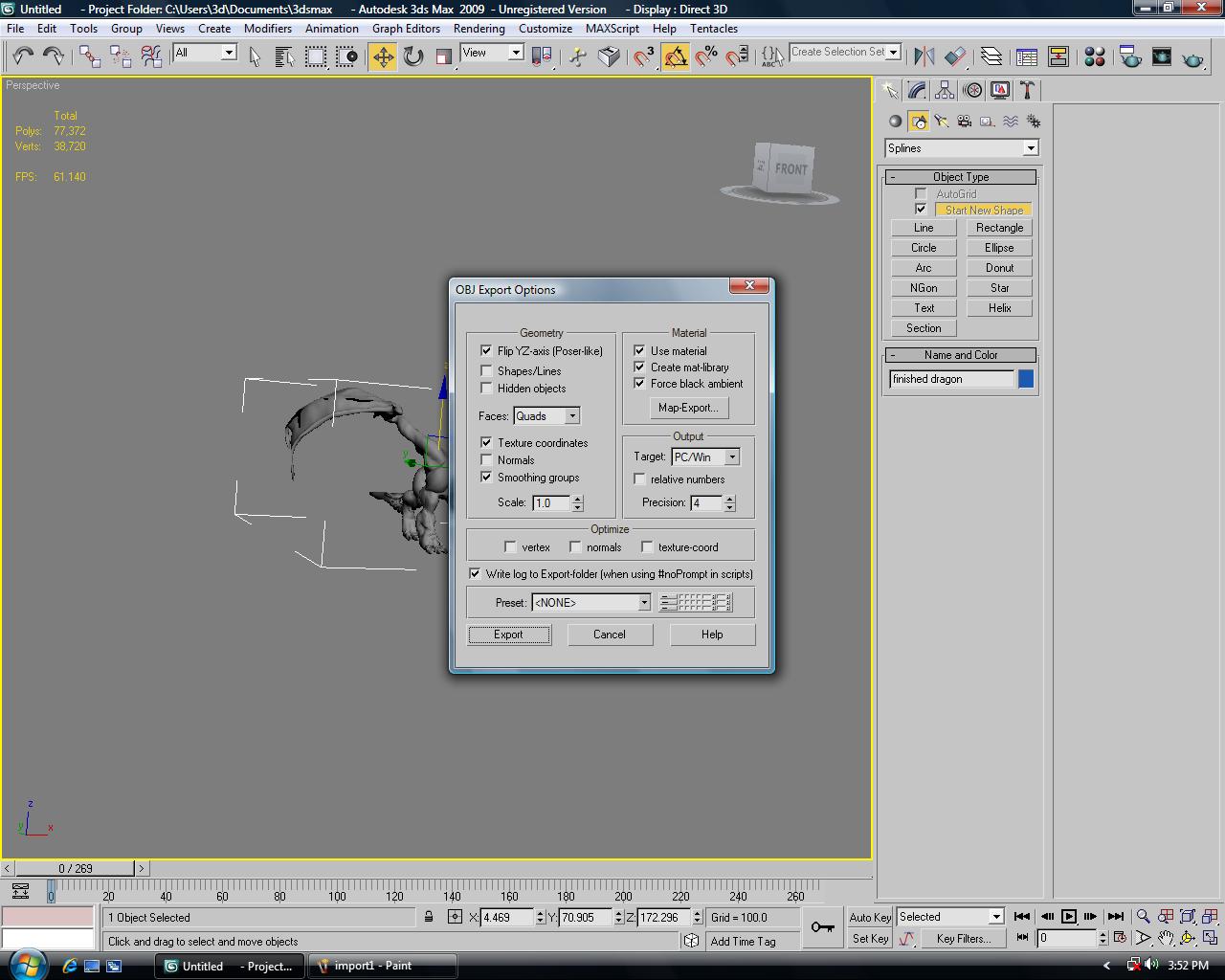

what are your import and export options inside of Max and Zbrush?

i don’t have any options for reporting from z brush it just says export it. also i noticed the points are slightly different z brush says there are 36820 points and max exports it back with 36968

import into max. turn everything off except texture coordinates.

export it…everything turned off but texture coordinates again.
