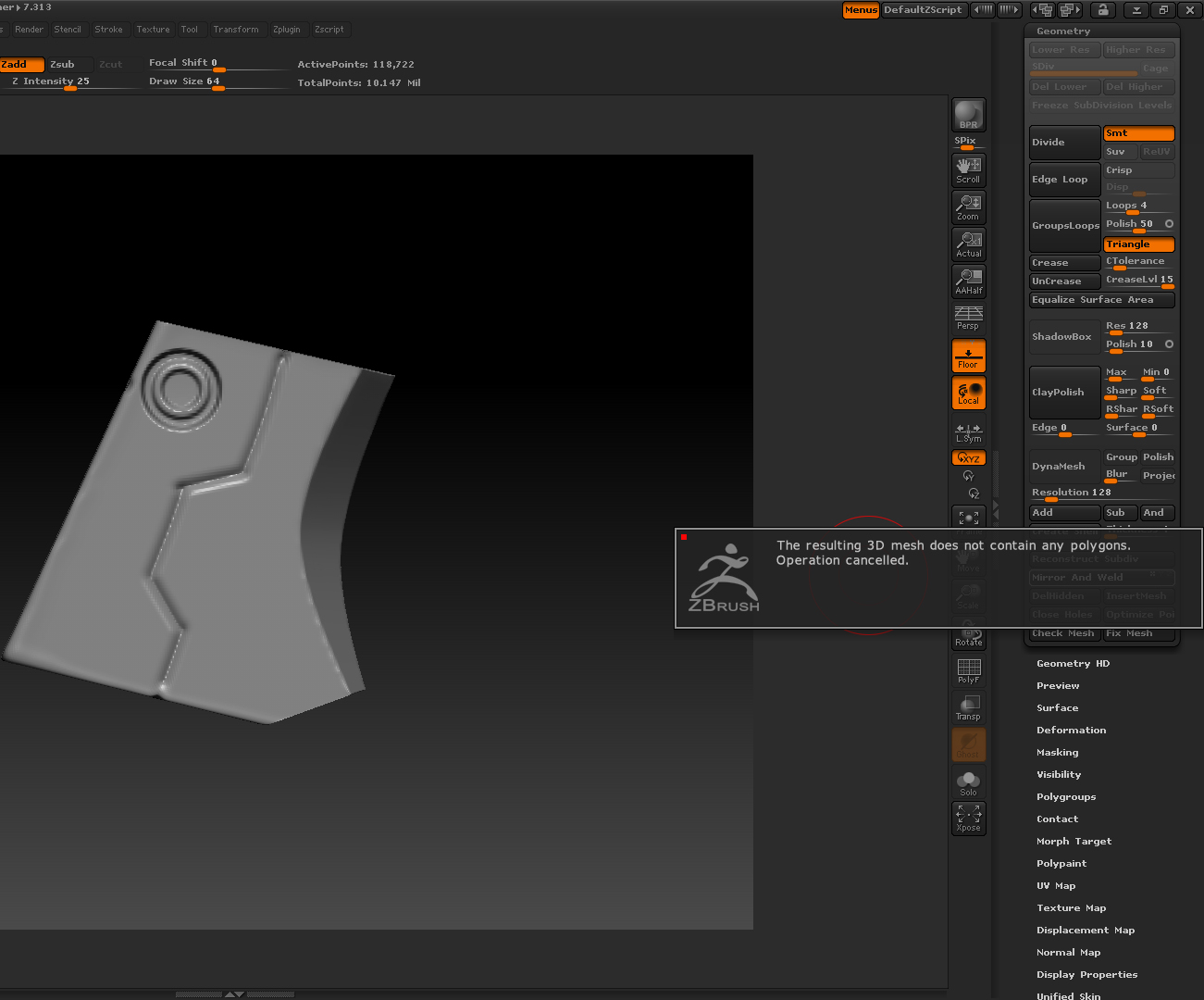

I’m using Zbrush 4R2
Here’s the error when I try to mirror and weld (I have no subdivision levels)

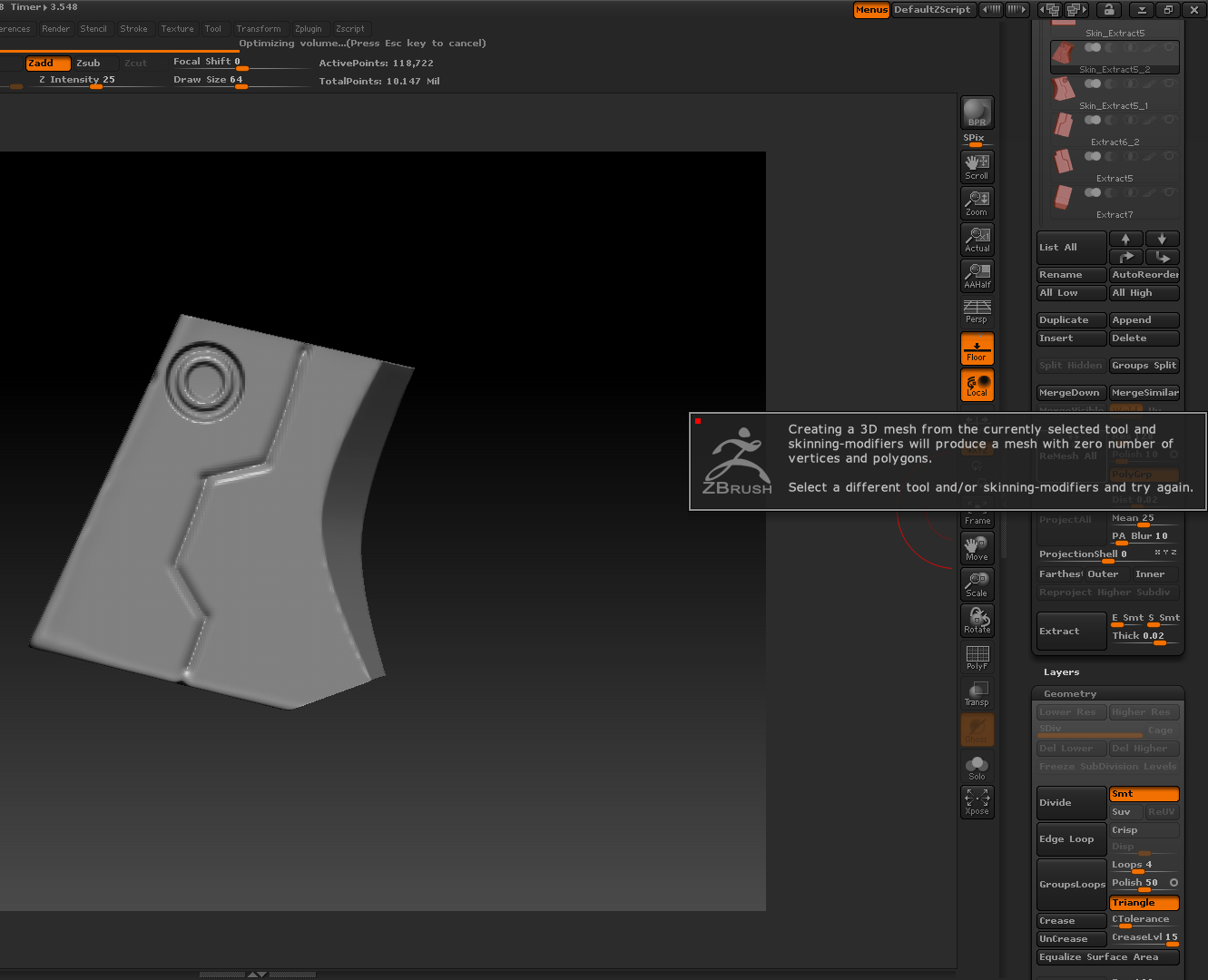

And Here’s the error when I try to remesh all
Do you guys know what’s wrong? thanks!
With mirror and weld what is happening is you are trying to mirror from the wrong side, turn on the “floor” so you can see the center of the “world” then you should be able to move your object to the other side of the center line.
Basically mirror and weld only works from one side, so your object has to move from where it is to the other side of the center.
If that makes no sense at all let me know it confused me too untill I figured out what was happening.
The Remesh all thing I cant say, but are you trying to make a Boolean? I had errors like that trying to make holes in things with objects that were bigger than what I was making the hole with…
MealeaYing, thanks for your help. I just realized that my whole mesh wasn’t in the right axis. Took me awhile to figure the whole thing out as I’m still learning how to use Zbrush. Because I have fixed the axis there’s no more error when I do Mirror and Weld and also no more error with Remesh All. Thanks a lot man! May God bless you and Merry Christmas!
