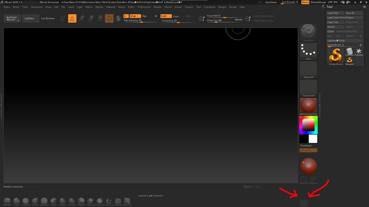

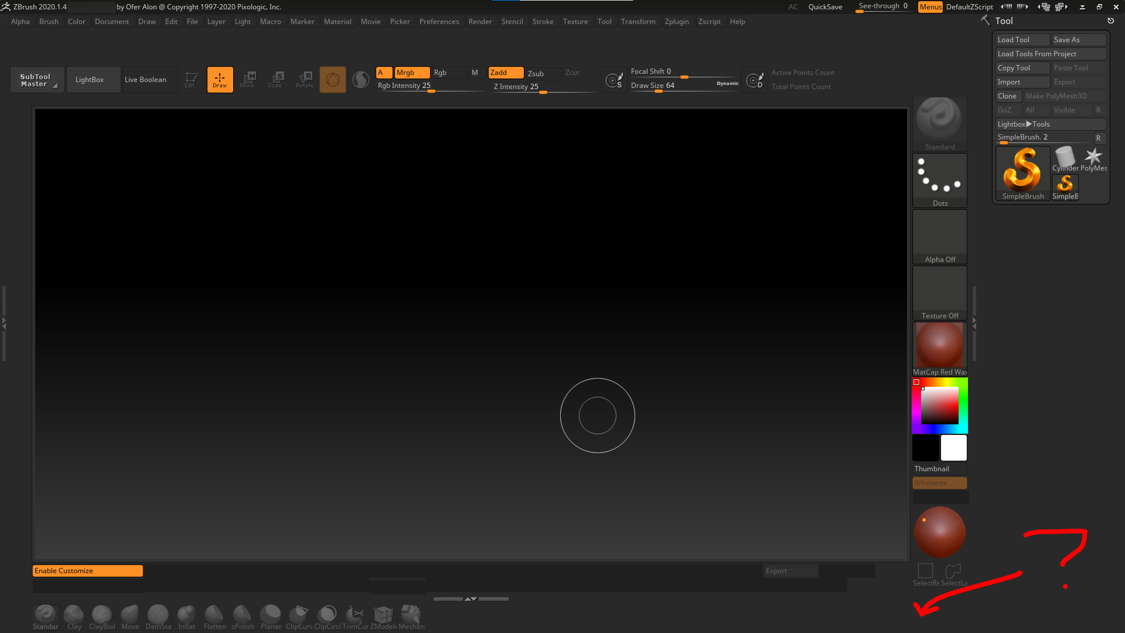

I am having a problem when using the Enable Customize feature. There is a button that appears in my UI that I want to remove but when I enable Enable Customize the button disappears or is “pushed down” out of view so I can’t get rid of it in the UI. Its the Xpose button at the bottom right(see image)

Hold down Ctrl and move your cursor beside one of the icons or buttons on the right shelf, you will get an up/down arrow. When you get that, you can slide the shelf up or down. It’s kind of fiddly because the area to get the up/down arrow is small. If you temporarily remove an icon from the right shelf like the Material icon, you can use that space to get the up/down arrow much easier. This works the same for all the shelves. Top, bottom left and right. Except, for the top and bottom shelves, it will be a left/right arrow.
Thanks zber2!
Thank you !!!
