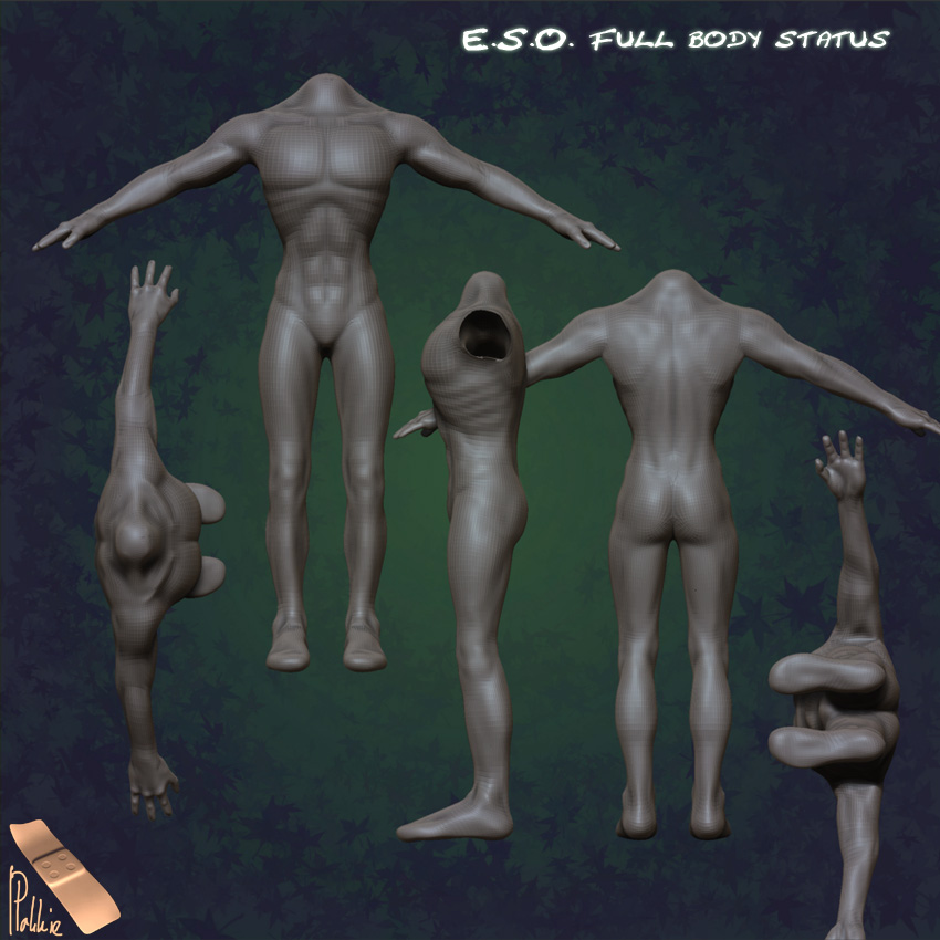

Elarcano: seems like you’re a Furry Vest-Fan too! :smiley: Thanks, I agree, and I include the current status of Cutter’s body. I moved the arms in a little, seemed more natural. There are still many faults, but most important are chest and arms, as they will be visible (no clothing). Any views you might have are most welcome, buddy! :+1:

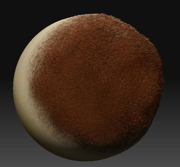

i made a alpha with alot of noise on it…now you can skip the masking and go straight to snakehooking ;)…i’m making a all fur animal at the moment :smiley:

i found placing the transpose circles in the right position really avoids the stretching, good modeling Plakkie and everything looks great ,but i think you need to lower the shoulders a bit tho and i would pay more attention to the torso around the chest and down a bit, abs looks fine but hey, that just me :slight_smile:
good luck :+1:
won’t share my aplha just yet…i only pre furred my model to see if it looks any good…still have to do alot of basic detailing first(so on the overal it’s not fully tested yet)…i coloured it as well to see what it would look like and deleted that 2…I have to learn how to be patient :wink:
but i did figure that i want to go with a less furry aproach…my model turned from nice and fuzzy to wild beast…so i’m still tweaking it.
plakster i can send you the aplha if you want to test it…but like i said…it’s not fully tested by me yet (not that it means much cus i’m still a newby)

Now I remember why I didn’t use alpha on snakehook:
When I used an alpha-brush I could only make the stroke once. If I wanted to ‘comb’ the hairs in a different direction I could never get the brush on exactly the same spot. By using a ‘hair-mask’ and a no-alpha brush I can always get acces to the same hairs as on the first stroke.
Does this make sense? How do you cope with later on changes Strict?

i’m not trying to hijack your thread…but i figure a pic speak louder than words.
with the alpha you can also paint different hi-lights in the fur…if your polypainting of course(this one i did in 10 seconds…it’s just a example)…i will also pm you the alpha to play with

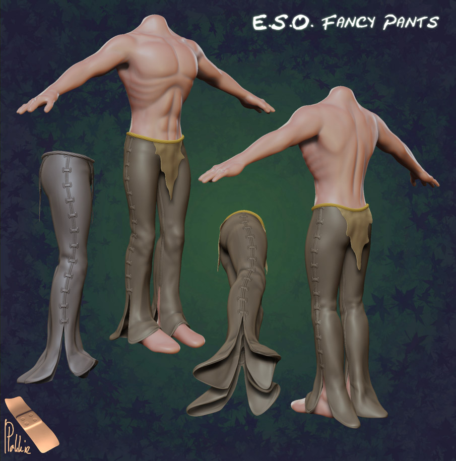

Finally the pants are starting to look like something!
[clothing3.jpg](javascript:zb_insimg(‘71719’,‘clothing3.jpg’,1,0))
Had a real rush with this. Basic pants shape done by extracting a mask from the legs, used the stitch brush with my custom made alpha, tried to sculpt some folds in the leather, but I have to train myself some more in that area. I twisted and deformed a basic ring mesh to get a rope, and draped that around his hips. I drew the basic loin cloth shape on a basic plane and extracted it. That way you get instant thickness and nice rounded edges. Draped them around his hips again (some more work required yet), et voilá. On the front of the loin cloth there is what I think a peacock feather in the drawings. I’ve no clue how I’m going to make one, but no doubt with Zbrush’s help I will get it done somehow. :slight_smile:
Brimming with confindence again,
Plakkie
I think you did a very nice stich work on it! Very good! :wink:
Hey Buddy :+1:
The pants look fantastic man!
My only observation would be that from the image of the pants from post Post#114 it seems that from the knee down it’s a bit more baggy and saggy (less tight to the leg)
Not sure, but maybe it would be easier to make the folds first and then add the stiches :roll_eyes:
Cool to see the progress, keep them coming :+1:
