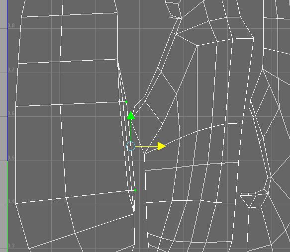

Hi,
I am doing my second model in ZBrush and have a bit of a problem. I have finished sculpting and doing now texturing when I noticed that on the sole of the boot that I am modelling uv are directly overlaying :eek: . I only need to tweak the uvs a little bit, can I do that in ZBrush without losing everthing I have done so far? Or somehow transfer the edited uvs on to the old ZBrush tool (original mesh comes from Maya 2009)
Help would be very much appreciated, thanks
