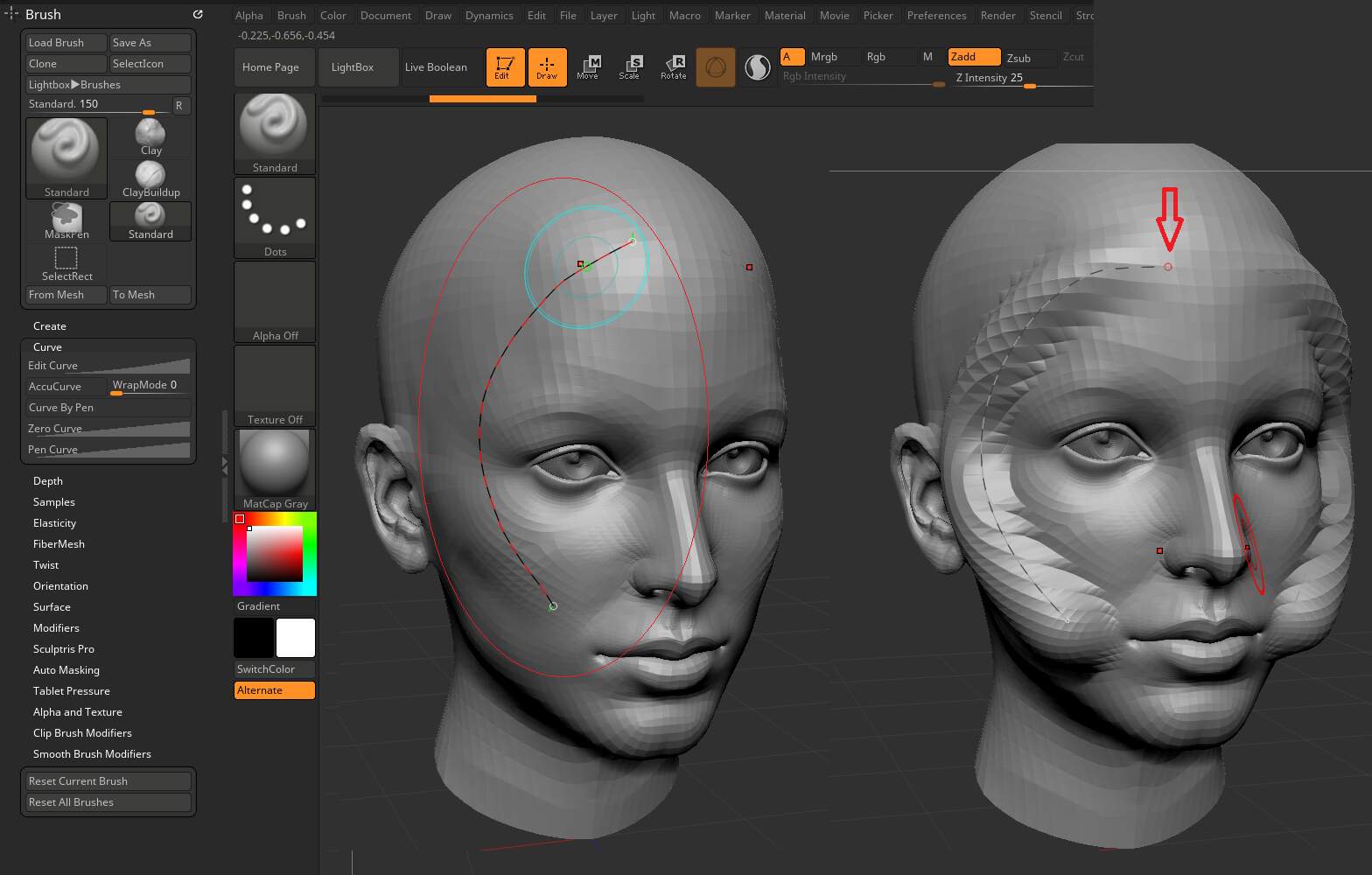

Hi!!! I just purchased zBrush and I’m extremely excited to be here!!! I’ve been polymodeling for the last 14 years, and I’m really ready to step-up my game and adopt sculpting. I was wondering if there was any way to edit a “stroke curve” after it’s been drawn.
For example, if I need the curve to be perfect, and it’s a tiny bit off. How do I drag points on the curve to the right location without activating the brushes?? Everytime I try to left click a point on the curve, it sculpts the entire curve onto the mesh :frowning_face: Here is a picture of my problem:

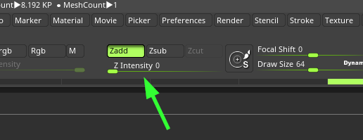

Just turn Z Intensity down to 0.
2021-02-12 06_30_11-ZBrush
Thanks-!
Wow… that makes so much sense I feel quite stupid -
I have one quick question then, is there any way I can set zBrush to automatically set z Intensity down to 0 when the curve is being tugged (left click down), and have the intensity return to it’s last value when left click is released??

No, there isn’t a setting to do that, but, and I should have mentioned this in my previous post but it slipped my mind (my turn to feel stupid :crazy_face:). Just turn Zadd or Zsub off and you can then leave the ZIntensity slider as is.
