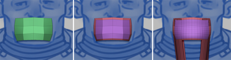

Hi guys. This is my first attempting of modeling in zbrush and i’m having some troubles.
I want to create a edgeloop to build a mouth in my character, but when i divide the topology in a higher resolution, something goes wrong… What can it be?
Thank you

What i believe you need to do now is use the “Freeze Transformation” button in the geometry pallet at the level you wish to do the edge loop.

You also have to hit the Equalize Surface Button after you freeze transforms but before you bring the objects back on screen. I explain this in more detail here. http://www.zbrushcentral.com/showthread.php?163649-Extrusion-Artifacts&p=910086#post910086
