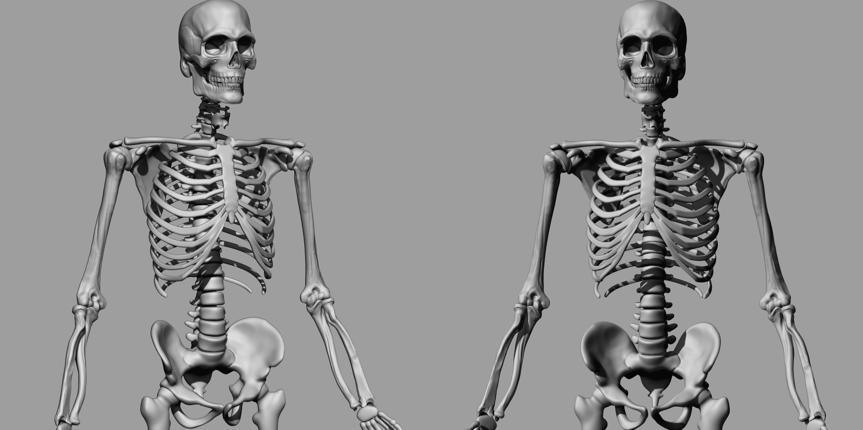

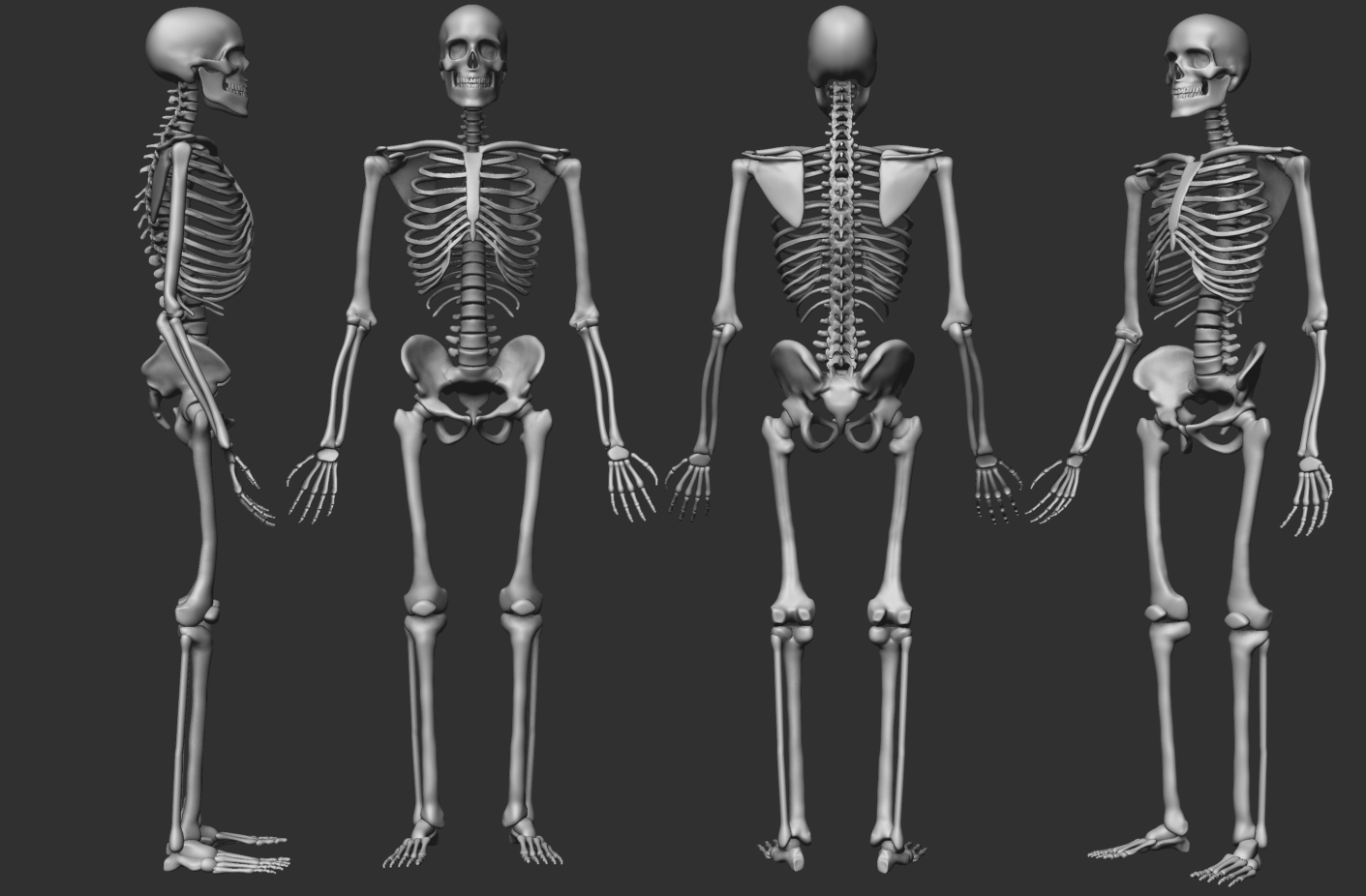

Hello I started this écorché project in order to learn anatomy. i started by blocking the skeleton made 100% in zbrush. looking forward for some C&C.

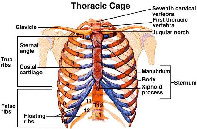

Thats a good start you have there. I’m not sure how detailed you want to get but there are some things that stand out to me. The rib cage shape should be a bit more like a egg shape with the narrow end point facing up. The ribs don’t typically attach to the xiphoid process. The Xiphoid process sits below the last connection where the cartilage connects the ribs to the sternum. The xiphoid process should be much shorter. The kneecap (patella) is more of a rounder shape. There are more things that stand out but that is a start to help out. When I worked on my skeleton I had to spend numerous hours looking at reference from all angles and I still can see areas needing improvement. My best advice would be to keep looking at reference material and when possible find actual skeletons to review vs an illustration interpretation of what the skeleton looks like. Try to not get too caught up on the differences that we all have. Its hard for some of us artists when we want to make something perfect, and there are so many variations to choose from that it sometimes slows you down, and you just want a definitive answer like a blueprint to work from. Good luck on your project. It is a lot of work but very rewarding, and can help you greatly with landmarks and anatomical terminology if you stick with it.
@Daniel Biggers: thank you for your comments, i tried to address them as best i can, still trying. I am not looking to detail anything until i block in all the skeleton and muscles, then i can worry about detailing. I am constantly looking for references and for the “blueprint” you told me about. It’s hard to come by extremely accurate anatomy.

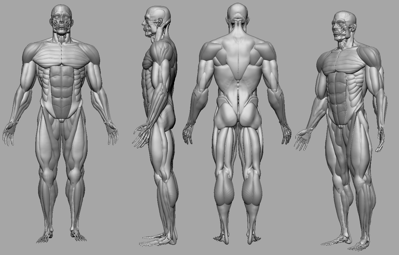

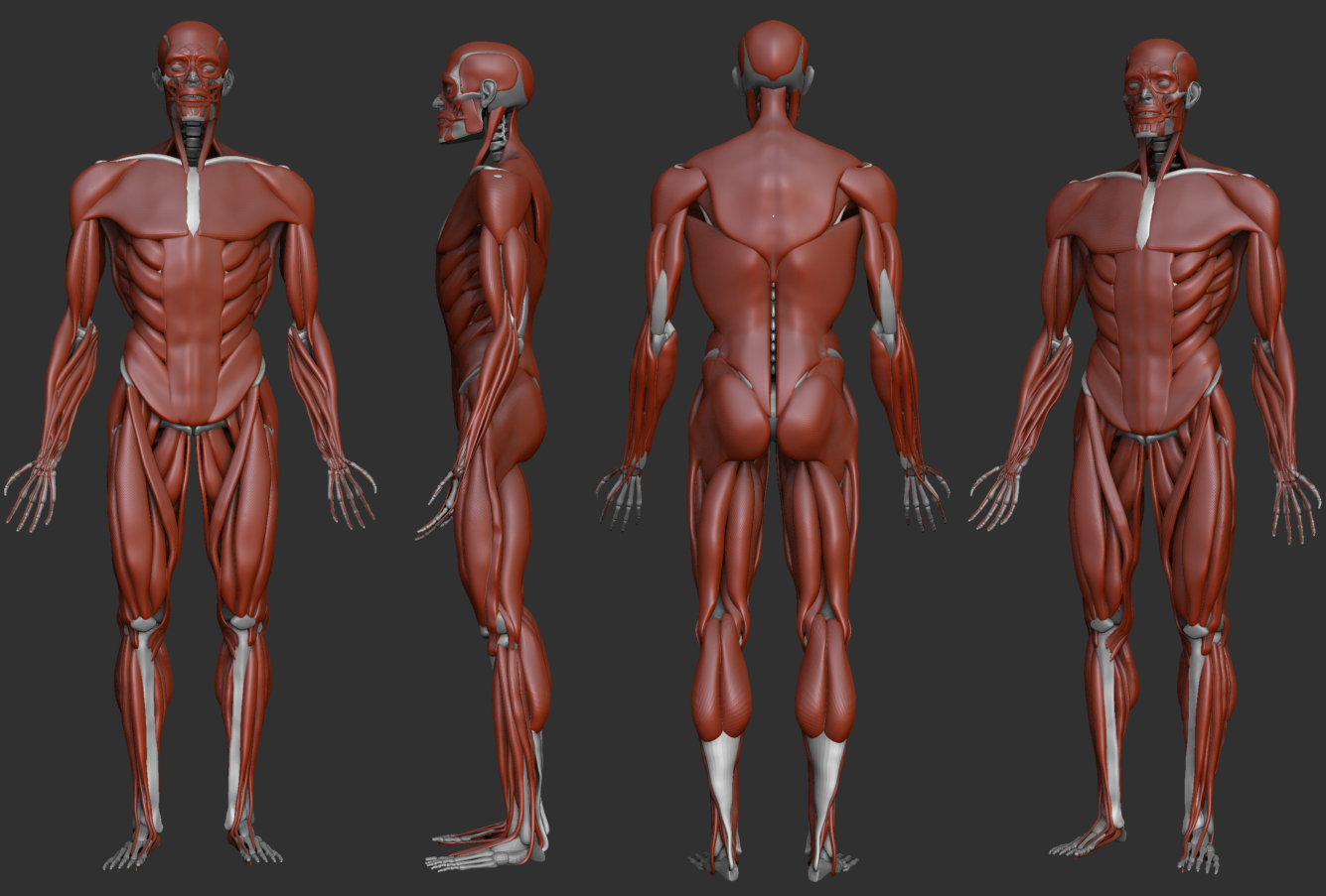

I blocked in most muscles using insert mesh and zmodeler and dynamesh. I am still trying to nail the proportions of the human figure (using Tpose plug-in). I still have to add the hands, feet and neck muscles and i can move to the detailing phase to rake in the muscles. The face also needs tweaking. I will also transform this man into a woman, that way i can have both sexes. 2 birds 1 stone ey?
i think the step after this will be to make the actual skin on top of the écorché.
Looking forward for C&C!

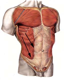

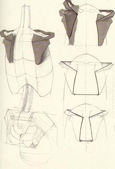

Daniel is right with all his critique for the skeleton. In terms of the model itself, I think it could use some more planar structures. Everything seems quite round and smooth. The skeleton has many complex forms, angles and planes and I think it is important to capture this. For example in the skull. These are some images from the Bammes anatomy book and a skull drawing from the Repin Academy.
A number of other bones in your model suffer from this as well (humerus, femur, tibia, fibula etc). Another thing, is that you forgot to model the manubrium seperate from the body of the sternum. They should be two distinct forms. I don’t know anything about sculpture and modelling, but in drawing, this is quite an important landmark in showing underlying form of the upper torso.
The scapula could probably use some work too. I’ve attached more images from Bammes.

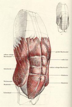

For the anatomy, the thing that stuck out the most is the way you modelled the external obliques. The digitation of the obliques should not be seperate forms like that but they should be connected to its main mass at the bottom. They should actually be quite thin and just lay ontop of the underlying form of the ribcage.
Something else you could do is the seperation between the three heads of the pectoralis major. The same for the three heads of the deltoids.
(I wanted to attach more images for you but, apparantly I’m at the limit haha)
Another thing you are missing out are the tendons and fasciae. For example on the trapezius, there should be a hollowed out diamond shape of fasciae where the 7th cervical vertebrae is. Also for the vastus medialis, lateralis and rectus femoris, they should connect to the knee cap with tendons and not directly.
Having a quick glance around the model, it looks to me like you’ve left out the brachialis and anconeus muscles on the arm aswell.

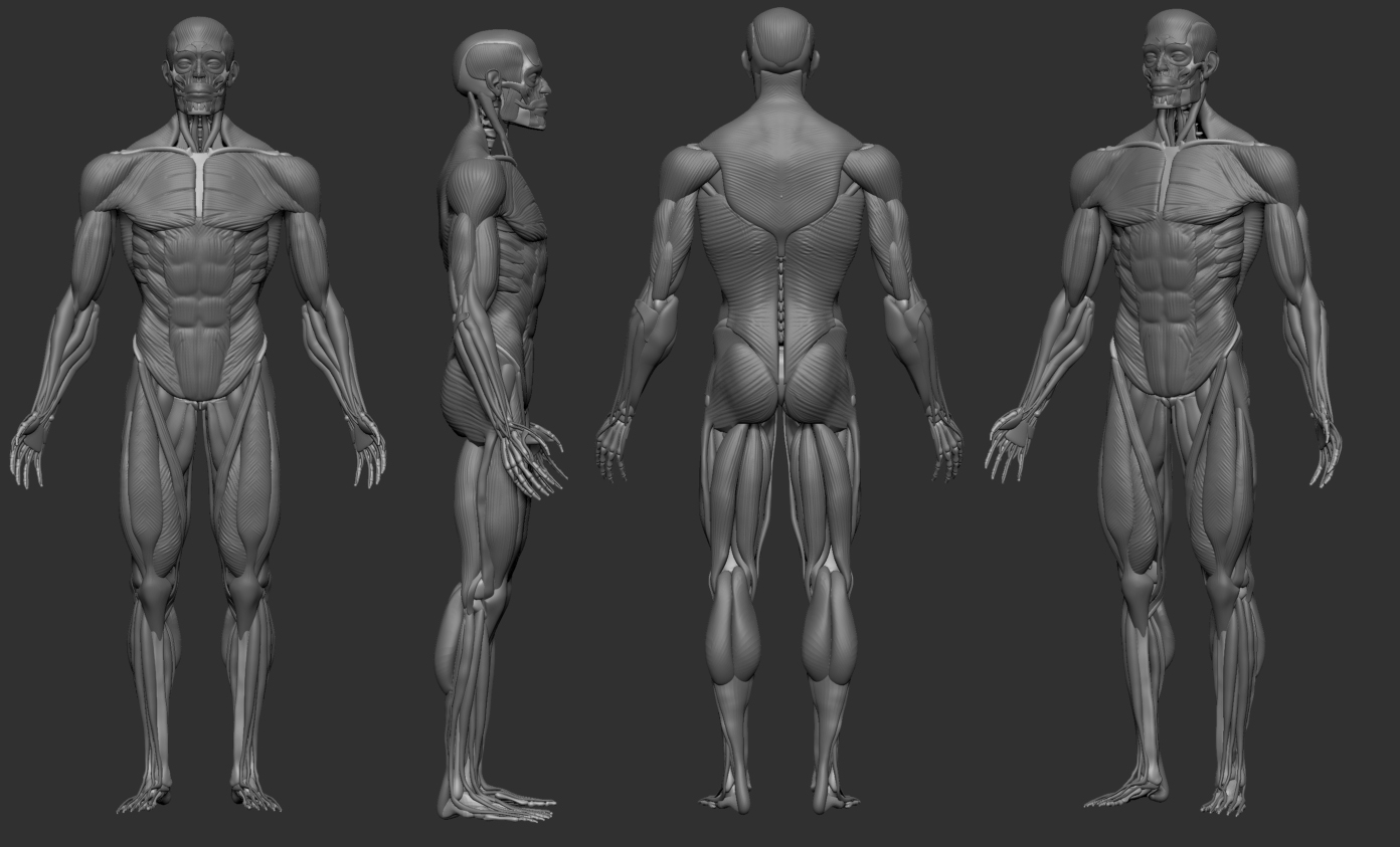

For the crits I would say look again at the serratus muscles reference and how they should look like an oriental fan from the side. They do not line up in a vertical line, and they are not as apparent from the front view since they tend to go off to the side more from the diagonal angle they make while curving around the ribs. The achilles tendon should narrow a bit more leading up to the Calcaneus (heel bone) and the insertion point is at the mid back section of the calcaneus.

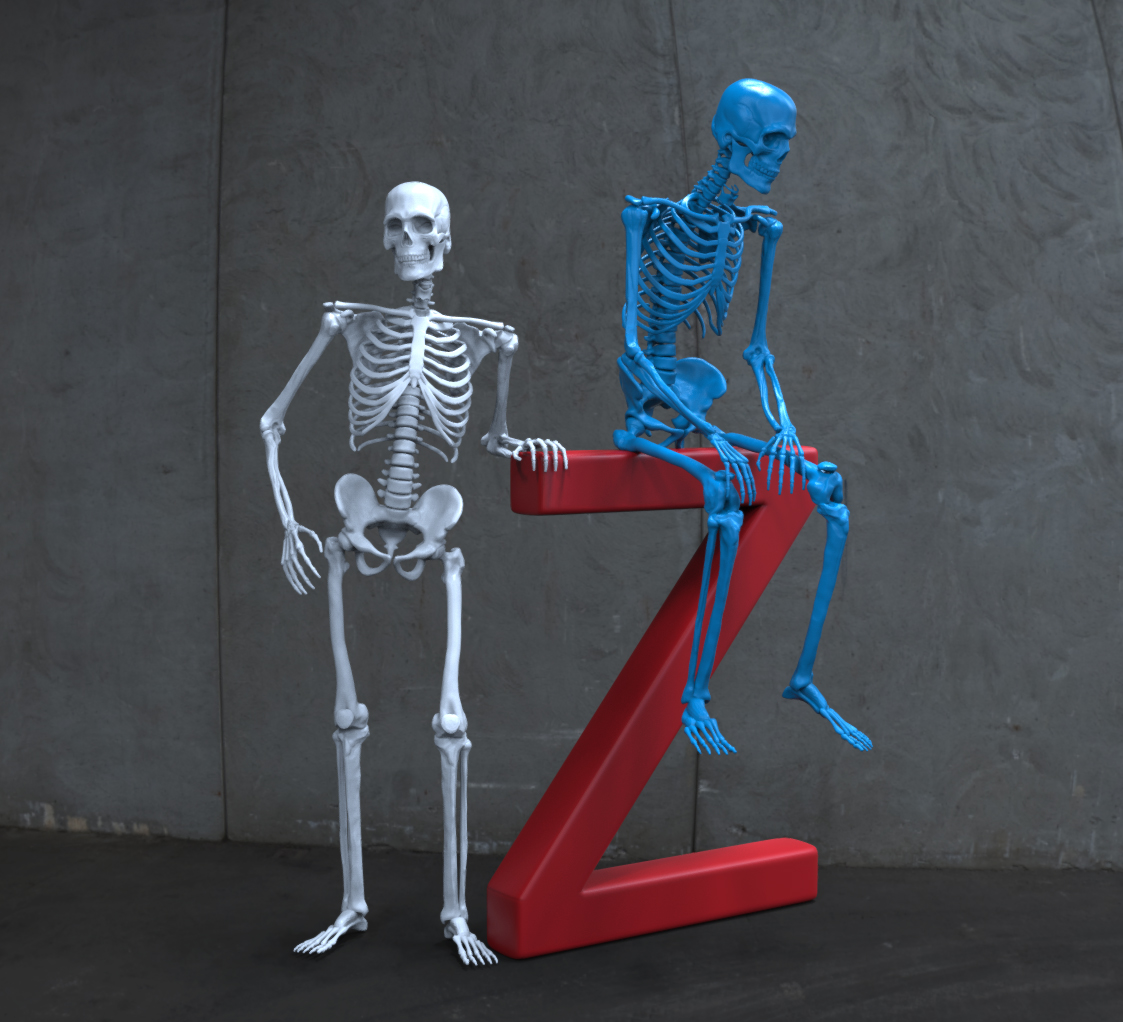

After a month of blocking in the major forms of calcium and proteins, ive started with some detail passes on cranium radius ulna humerus clavicles and scapula. had to remodel the thoracic cage 4 times LOL i think i will remodel it some more times yikes

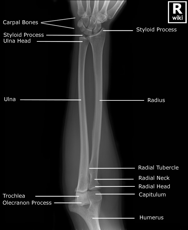

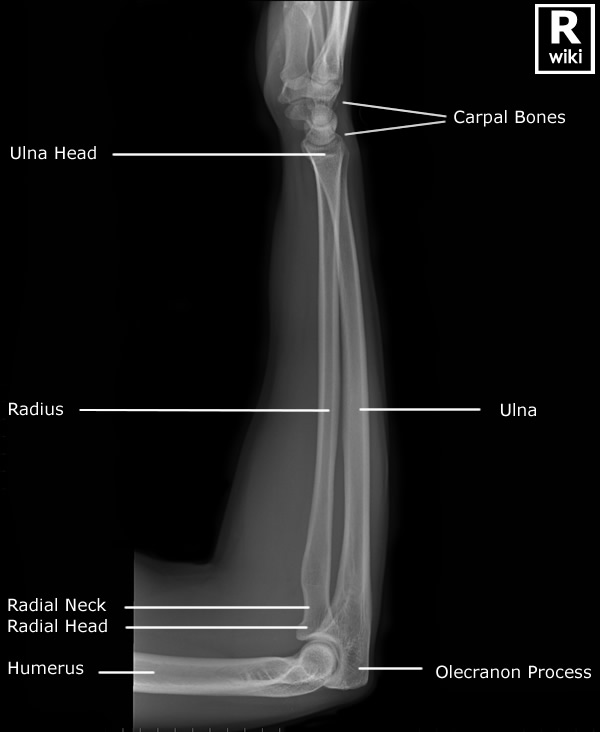

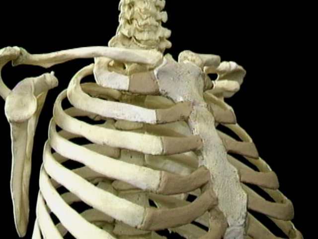

Its looking better. Take another look at how large your collarbone is near the manubrium, and the collarbone should attach towards the side. In the model it appears to be behind the manubrium. I also agree that there should be some separation of the manubrium as a landmark for the sternum, you could make it a separate piece as I did or just use the dam standard brush and carve in the separation line. The forearm bones are looking better but still require just a bit more work. Take a look at the attached images. I know you must have some reference of your own to get you to this point and it may vary a bit from the images attached, but they are a good reference to compare to. Both images attached are from the right arm.
The first image is with the arm out to the right and with the thumb side up showing the lateral side (the side away from the center off the body). The second image is with the posterior (back side) of the arm on the x ray table and the thumb is to the right showing the anterior portion of the arm.
Notice in the first image how the ulna is almost straight with a very slight bow in it. The radius from this x ray is also pretty straight as well once it passes the radial neck. The second image shows the bowing out/curves of the two bones. Also you may have it in there but make sure you carve out a section where the ulna and radius meet (near the wrist) since there is a grove in the side of the radius that the ulna sits in. I hope this helps.

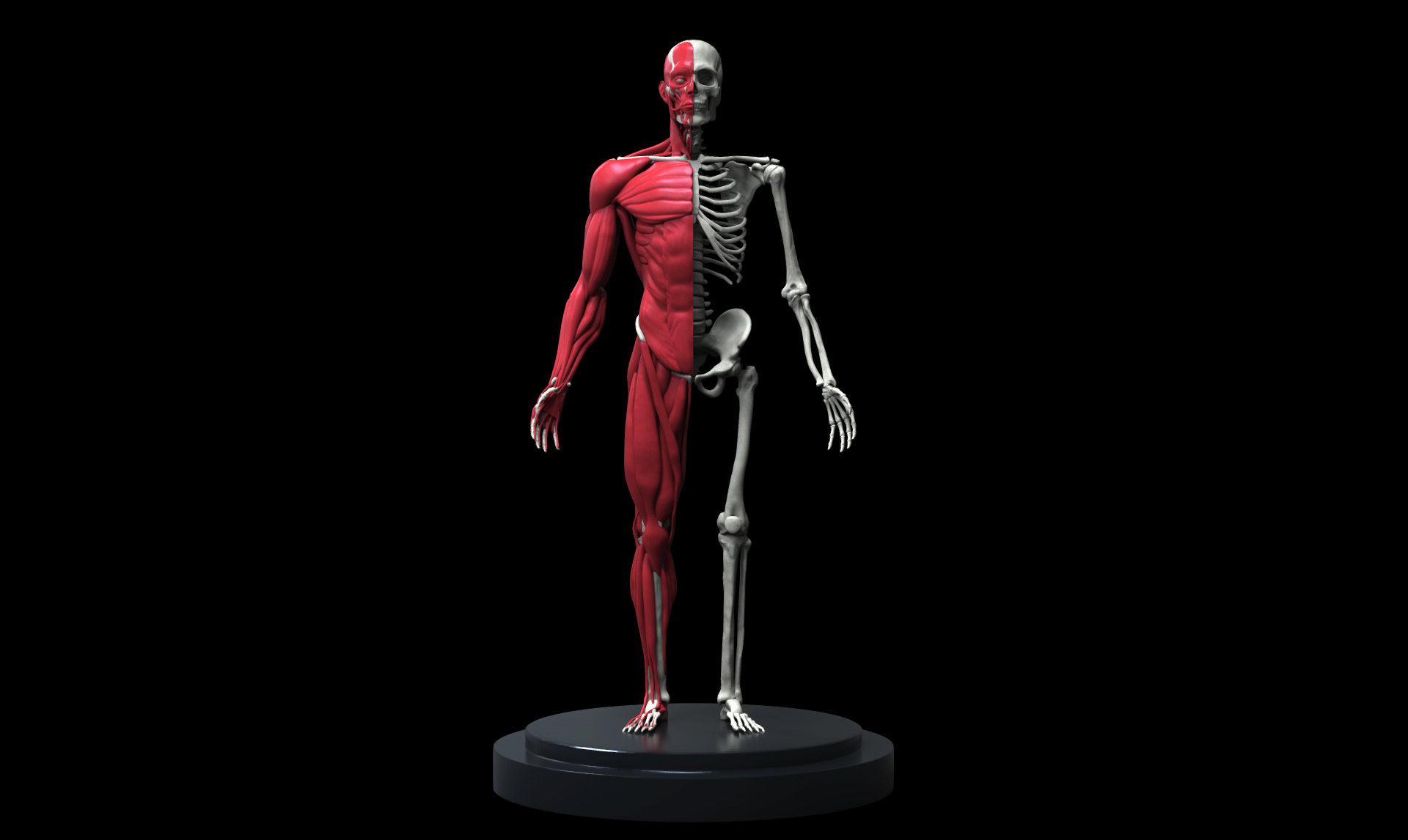

Quick Keyshot render for fun
@Daniel Biggers I have a seperation for the manubrium in the sternum but its not showing, i premodeled it with edge loops. As for the collar bones i still need to tweak them. And WOW those XRays really hit the spot! im still analyzing and understanding the humerus ulna radius structures and fixing them as i go. Really cool XRays

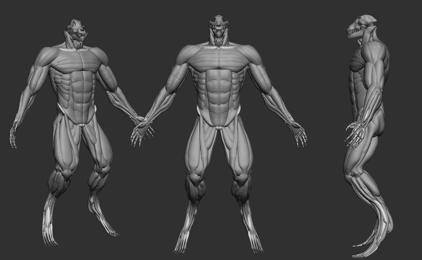

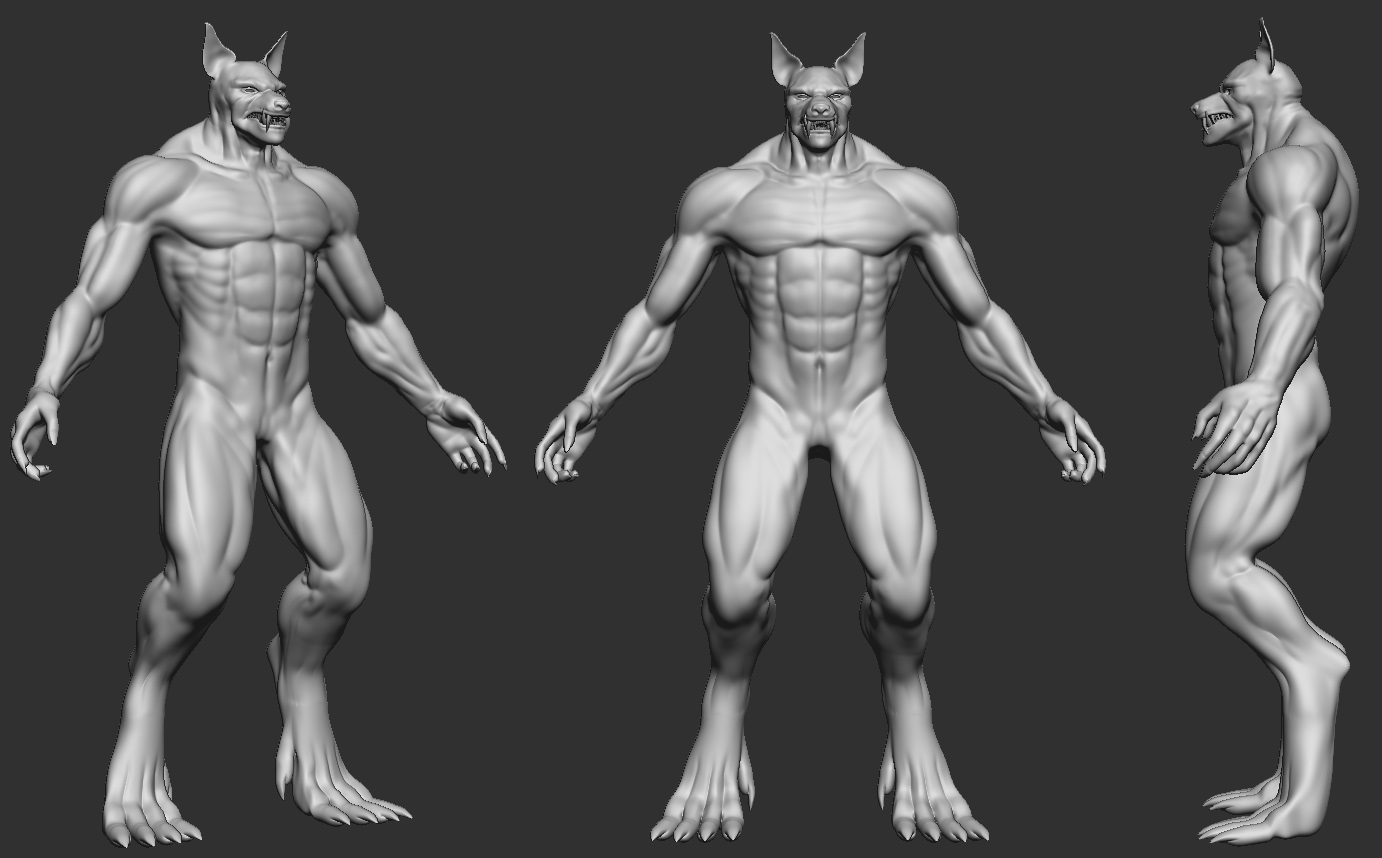

so i took my ecorche, tposed it into what could be a worgen and then retopologized it.
sculpt on…
I feel like the head should be a little bigger. Nice work.
