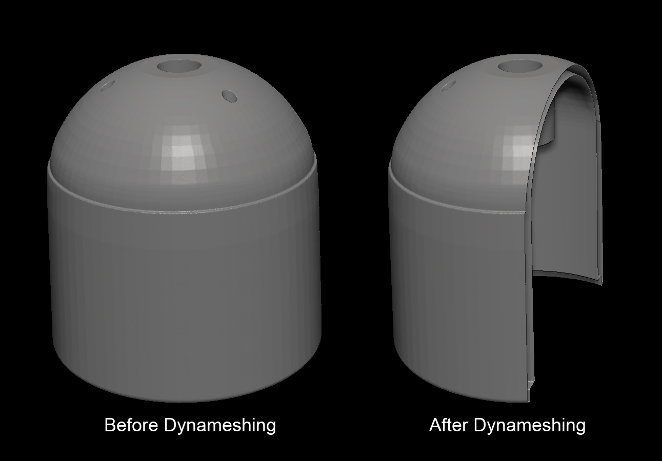

This is a decimated subtool with no subdivision levels. This happens no matter what the dynamesh resolution is set to. I’ve tried exporting and importing it back. No luck there either. This happens about 40% of the time and really bugs the crap out of me. What am I doing wrong?
What I have been doing is working around the problem instead of solving it. I remesh and project then subdivide and project again until I’ve got an identical subtool.

but i think i can help you… this happens because your model is to large for dynamesh to calculate the volume of your model correctly, if you click on tool than deformations menu and click on unify it should solve your sheering off the back of your model problem once you try dynameshing it again… please let me know if this helps you and solves your problem your having at the moment… hope it helps friend… :wink:
