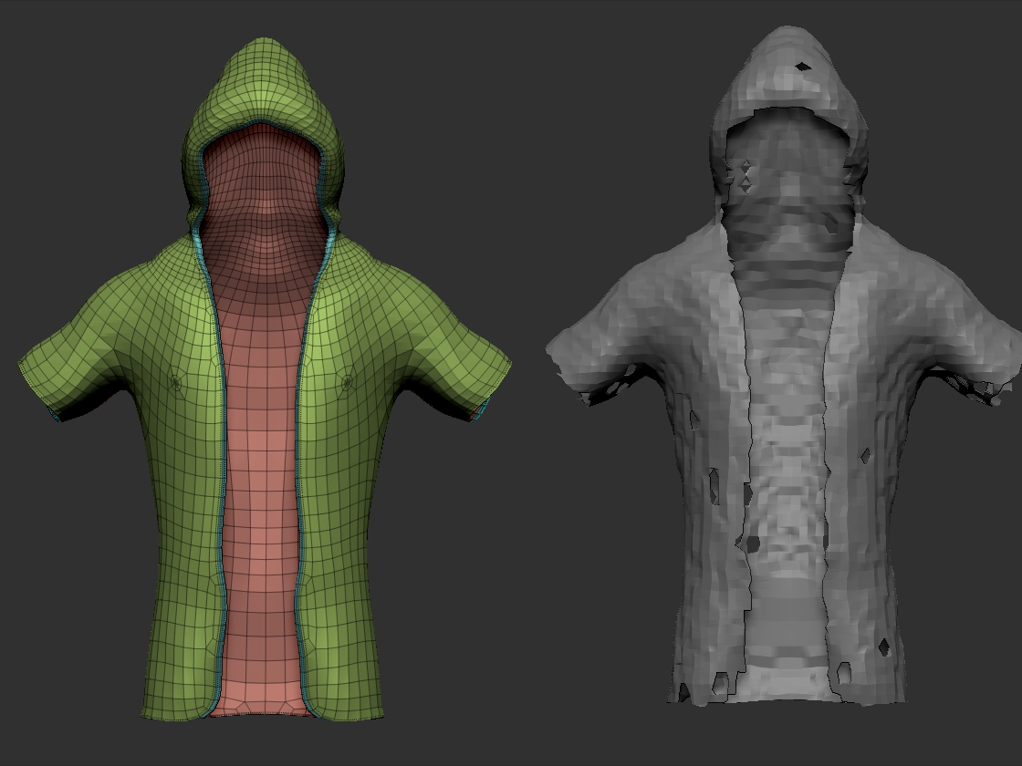

hi guys i have big problem when I was used dynamesh my model.model does crash what can I do that Can they help me one pls?
Add some more thickness to the jacket looks like it’s too thin.
if that not help try to raise resolution of Dynamesh a little bit.
Your dynamesh resolution is to low. Increase it. You need to have a higher resolution for thinner mesh. The same goes to small scale mesh.

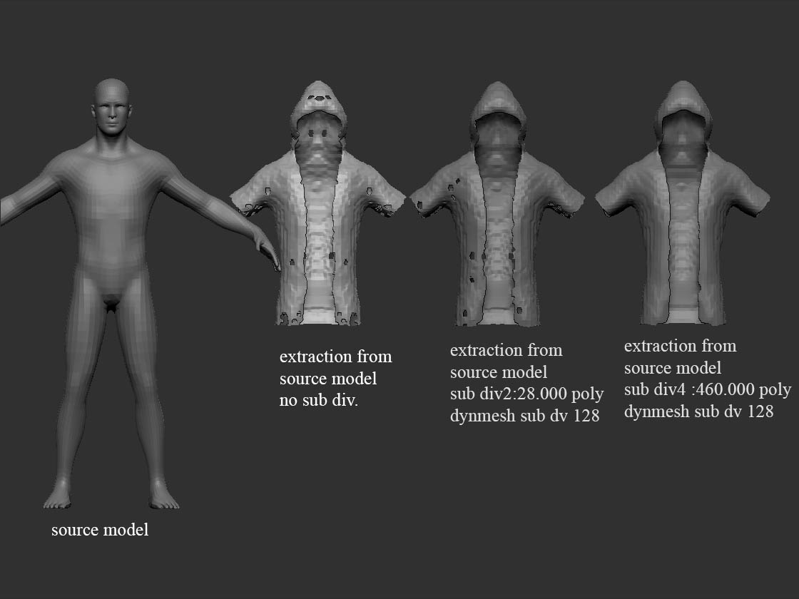

thanks for answering I’ve had some trials,If you pay attention,high subdivision model surface very faced I cant see smooth normal surface.this is normal ? when I was used standart sphere dynamesh mesh has very smoothness i dont undertand and I’ll try high thickness
