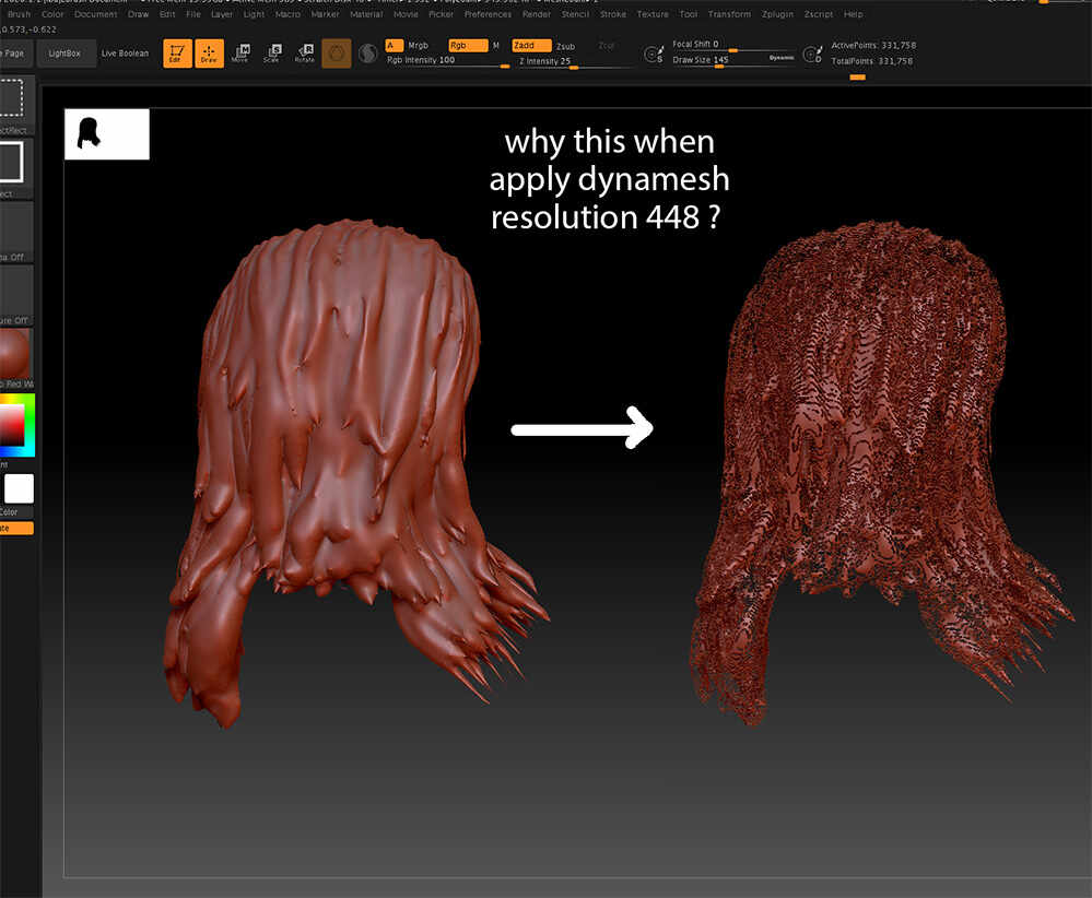

Hi.
i attach a picture showing dynamysh wholes when apply resolution 448
i already close holes on preference geometry, but always same.
please how can i fix this … or why dynamesh do this ?
thank for any comment

Hello @untalmau ,
Basic troubleshooting:
  1. Experiencing odd behavior with a mesh in any situation? Tool> Geometry> Mesh Integrity> Check Mesh. If your mesh reports any issues here you must fix that problem before you can work with it safely.
  2. Dynamesh needs a closed, watertight volume with some degree of thickness. Any areas that are 2D or too thin will begin to break apart.
  • Are there any gaps or odd topology that would cause Dynamesh to read your mesh as an open volume? If it reads as open it may see that as a thin 2D surface rather than a watertight solid which would cause it to break apart.
  • Are there any sections of overlapping geometry? What happens if you try Subtool> Split> Split to parts?
  • Are there any sections of interior geometry that could be complicating the form? Any interior facing surfaces? Remember Dynamesh must be able to read that as a watertight solid and not as overlapping 2D surfaces.
If nothing mentioned above explains your problem and you’d like us to take a look at the file, please contact ZBrush Support.
