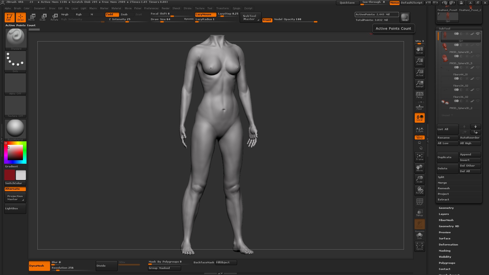

Hello guys! i’ve got stucked with a problem, when i try to increase Dynamesh resolution it remeshes it but doesnt increase polygon density of the model. How can i solve it?
Thanx in advance!!!

does your model fit in the tool.preview window? Dynamesh is linked directly to scale.
Also…you don’t need any more resolution within dynamesh, you should be using subD levels at this point. Dynamesh is to get your forms, not your details.
1)the model is too big and doesnt fit preview window. never knew that’s the matter.
So I’ve scaled the body down, now it fits preview window

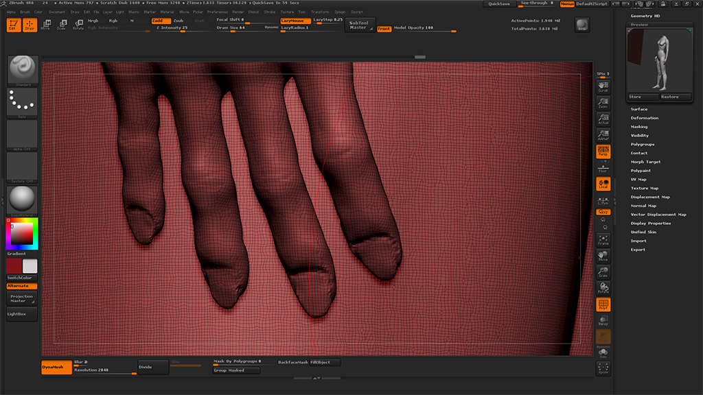

but after re-dynamesh it even at 2048 - polygon density is the same (+blures) as at 256
If you have them spliced together, it’s time to get out of Dynamesh. Looks like you need to check for program update too. Everyone else is using ZBrush 4R6 P2. ZPlugins:AutoUpdate
thx, i’ll try. hope this is gonna solve that
